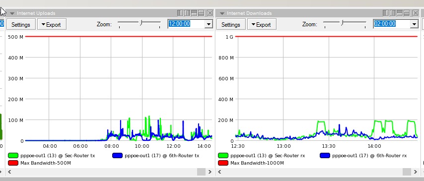

In the first two cases, download speeds never exceed 200Mbps. See below:
When trying with a large download file, every 20 seconds the bandwidth is throttled to 200Mbps, then starts to increase again before being throttled to 200Mbps again. The cycle continues through the entire download.
