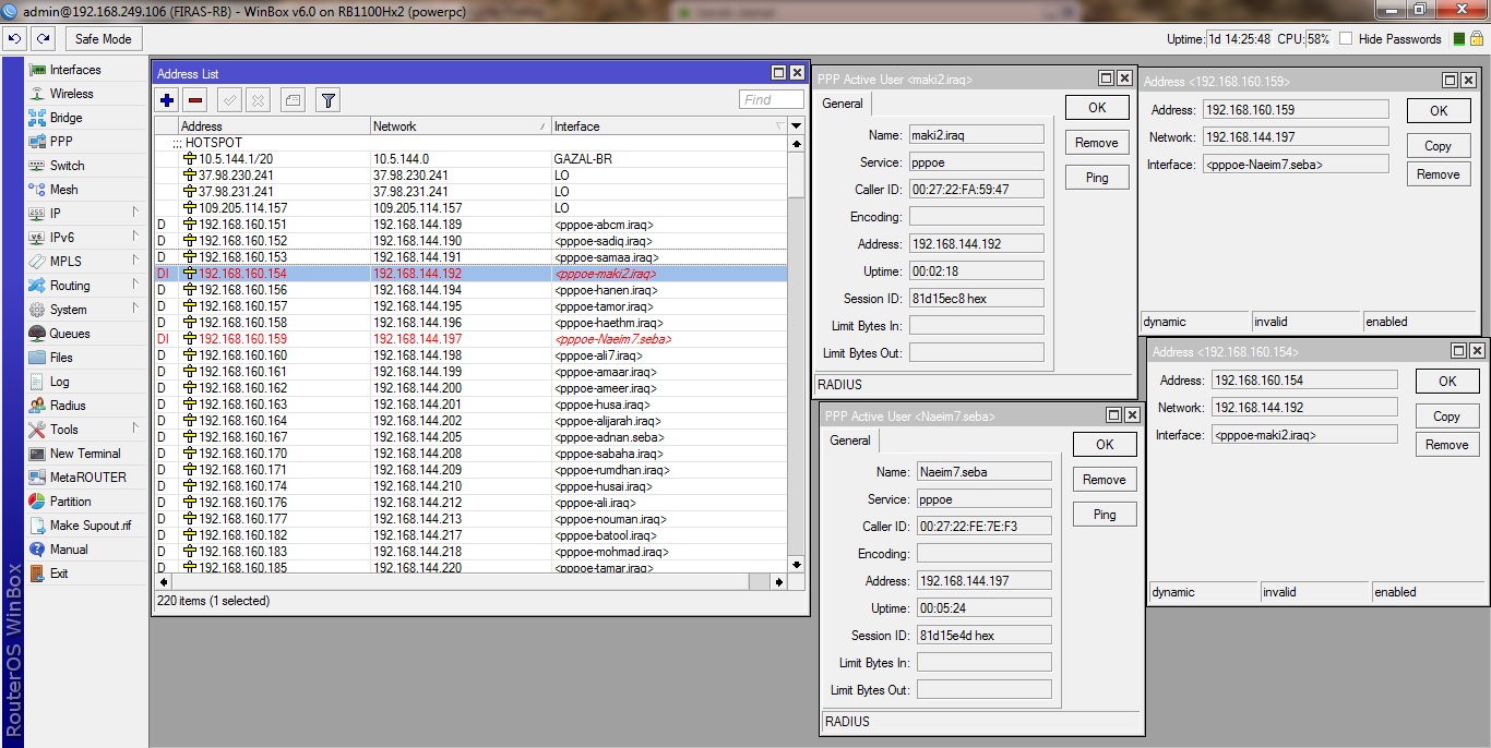

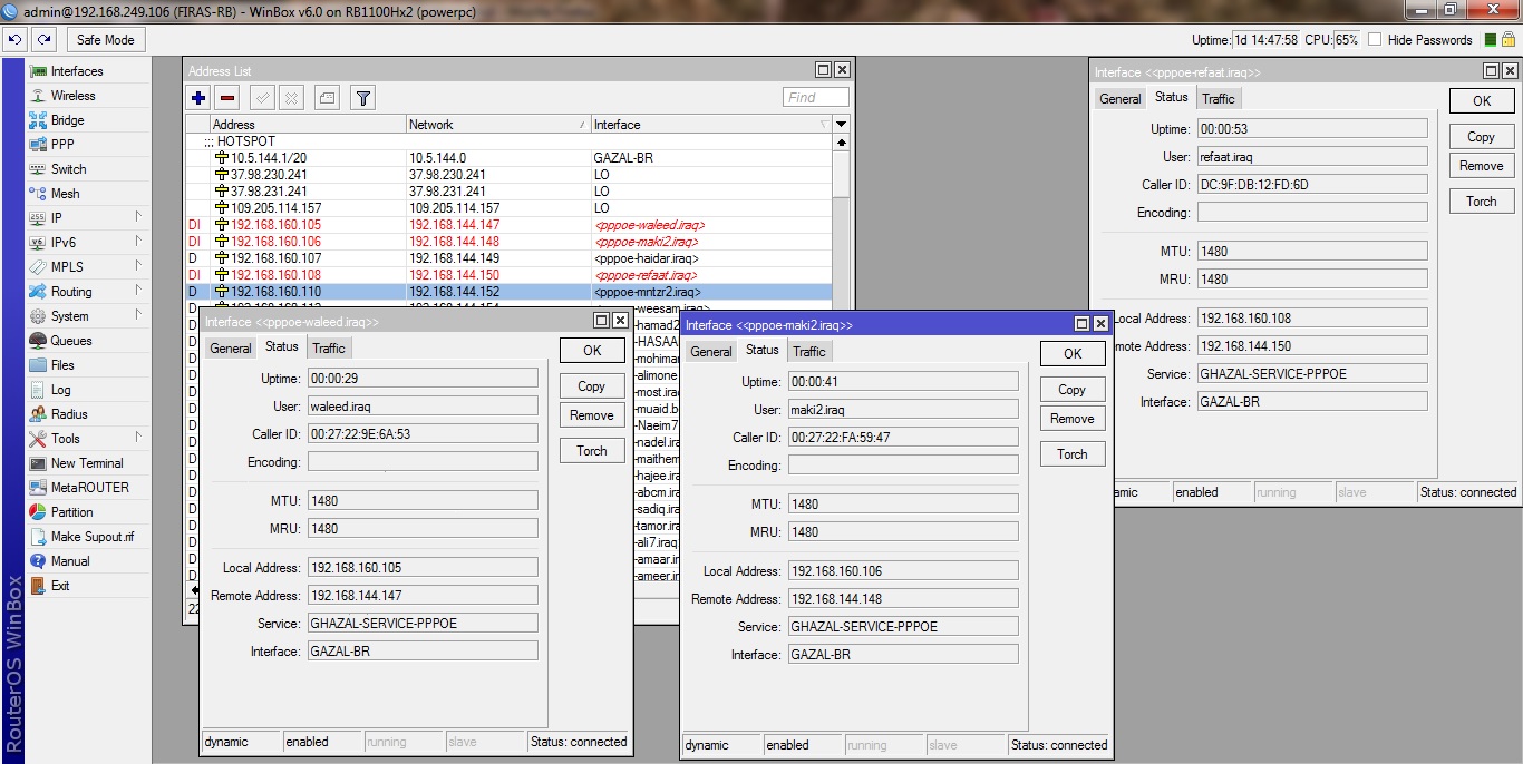

Please check the below issue , even when disconnecting the user from the active sessions , the same / or another user logs in with an invalid IP ( pppoe interface not running )

show working interfaces. do they have ‘running’ state?
Thank you for the response
No, They don’t have “running” state
just the D for dynamic
so any ideas?
just so you know , I emailed the support 3 weeks ago , and no beep from them so far
hm… so ALL interfaces are not ‘running’, and only some of them have invalid addresses?.. as I can see on PPTP, they are in R state - don’t have any PPPoE to check

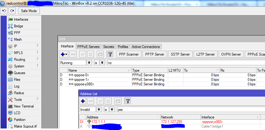

Same here witch ccr1036, only dynamic not running, no route created,solves only when restart.

We see the same Problem. We use pppoe with ca. 400 interfaces on a RB1000AHx2 and discoverd the same bug - Ip Address List shows roughly 9 ivalid entries. Kicking them will have them reappear as ivalid; kicking all interfaces or rebooting will have a different set of roughly 9 ivalid entries.
