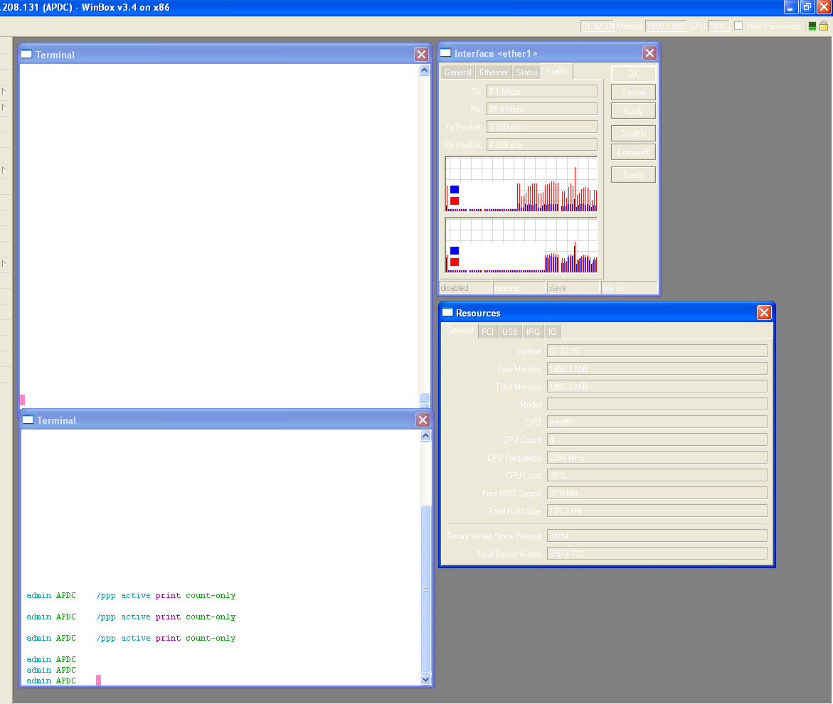

we have big problems with performance of PPPoE server running 3.x versions. Today we run 3.4 version and still having problem. The problem is that we have packetlose on localhost (127.0.0.1) and all interfaces. It seems like it is a performance problem or problem of interface queues.
We run PPPoE server with quad core cpu xeon 2400, with board chipset intel 3000 server chipset with two gbit onboard ethernet cards. Traffic is up to 40/10mbit download/upload.
Enclosed is screen copy of our pppoe server. You can see packet lose to address 127.0.0.1 and high ping time response. Can someone observe the same problem?
We have this problem on all PPPoE server under heavy load.
