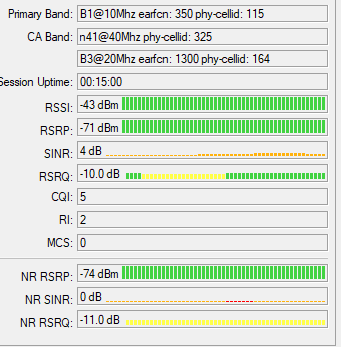

I have two questions related to the 5G NSA. My current operator has mast with B1, B3, B8 and n41 and I’m connecting to this using 5G NSA.
  1. I cannot connect using all bands - it could be done only (B3+B8+n41) or (B1+n41). The first option is done automaticlly by router the second option is possible by manual allowig on LTE side only B1 band - without forcing only B1 band, the router even doesn’t see this band. It’s my fault that I cannot aggregate all bands B1, B3, B8 and n41? Should I make some changes with pigtails on modem (I’m using Chateau 5G) or it could be the issue with operator mast? I was testing other operator (which had B20, B3, B8, n1) and here I didn’t have any problem, router was picking all the bands in one time (in 5G NSA mode).

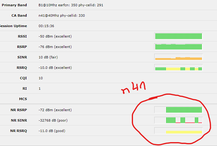

  2. Today (I mean 16/10/2022 on evening) the router has problem with stable work with band n41:
the router even drops completely the n41 band (and switches from 5G NSA to LTE)
Here I also tested competition operator and the 5G band (n1) is working correctly. Not sure if the mast currently is facing the highest peak of users logging/using this mast - or I’m facing an other issue here? I collected some logs from modem.
Worth mention will be that I’m using this operator for couple of days. Normally the SINR for n41 I had 26-30dB (all the time) and this situation has never happened until today.
My setup: MikroTik Chateau 5G + QUPANEL 5G LTE HP MIMO 4X4, 5M (AP5G4).
The antenna is connected using ports A0, A1, A4, A6 on modem.

Even weird that the primary bands gets sometimes very strange number on eafrcn (probably max int32?):

Interesting thing - when I switch from (A0, A1, A4, A6) pigtails to (A0, A1, A5, A6) then this help me - now I have stable connection to the n41 (as CA):
Not sure if I get this correctly, but probably the router tried to connect to BTS using A0 and A1 for LTE B1, B3 + 5G n41? and this created some kind of race condition on modem?
and after when I splitted connection for n41 on port A5 and A6 could help? (I don’t have any technical knowledge background with telecommunications, so I could be wrong)
On doc (from modem) I see that there is some bold information for n41 one pair on A0+A1 and second pair A5+A6 (so this suggests that we could link with n41 on A5+A6 - and that’s why I changed pigtails):
Is there any way to check which bands are using antenna ports?
EDIT:
After restart of router it started again dropping connections (for n41) - but sometimes it is able to catch this for a long while and works stable.
On the end - still it’s better than on previous setup of pigtails.
