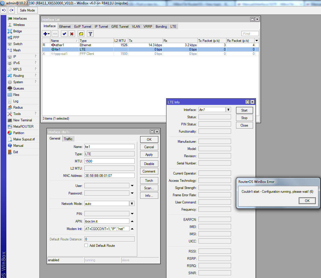

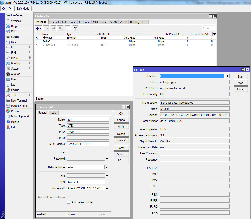

The modem MC8092 in RB411U with FW 5.25 works good (internet navigation works!) using the LTE Interface (is running state):
I cannot use the modem with FW 6.0, the LTE interface doesn’t run and I cannot read the information in the LTE Info, the message box says: Couldn’t start -Configuration running. please wait!
WHY?
IS THERE A WAY TO USE THE MODEM AS A PPP-CLIENT INTERFACE?

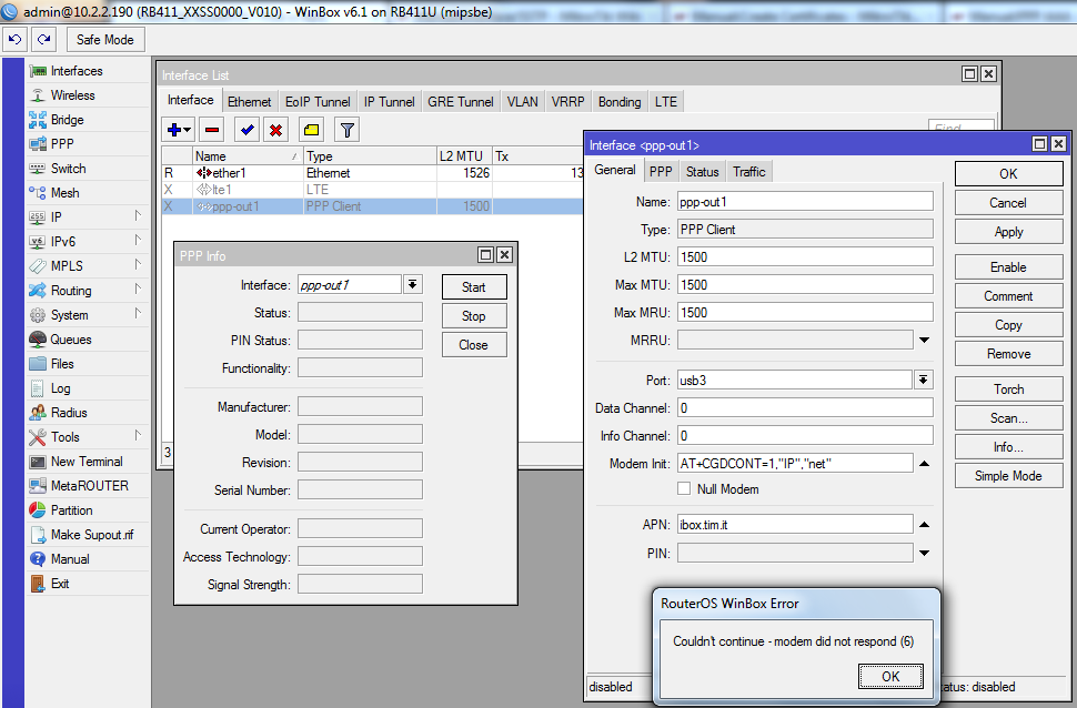

I tested the MC8092 with FW 6.1 and it works! Great!
Now my question are :
  1. IS IT POSSIBLE TO USE THE MODEM MC8092 AS PPP-CLIENT?

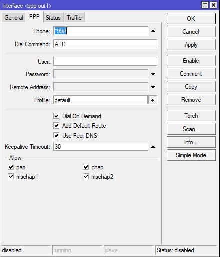

  2. HOW CAN I CONFIGURE THE AUTHENTICATION MODE PAP, CHAP, MSCHAP1 & MSCHAP2 IN LTE INTERFACE (User and Password)?
I had the exact same symptoms, on both OS versions.
Turned out if I connect the external antenna, then the interface turns to “running” and connects flawlessly. :sunglasses:
The interface does not turn to running without the antenna connected.
Solved in http://forum.mikrotik.com/t/mikrotik-rb4xx-with-sierra-wireless-mc7710/67336/1
