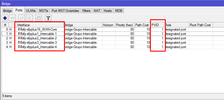

I got a switch which have 1 trunk (tagged) port and 4 access port (untagged).
I have my untagged ports with their respectives VLAN IDs but in “Ports” i do have the default PVID in each port.
It is working fine but i would like to know WHY? as far as i know PVID MUST match the VLAN ID.
I also know if i set the PVID for each port, it will create dinamically the untagged VLAN ID for each different PVID set in the port window.

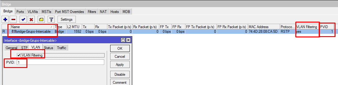

As you can see in the following pictures, there is one VLAN dinamically created with VLAN 1 for all ports as untagged.
I show some pictures attached.
Why is it working if PVID must match the VLAN ID? This is just a question in order to understand deeply those concepts in MikroTik.

Hi!, i really appreciate your response but i dont really understand.
Which PVID should i use on my bridge and which should i use on my trunk port (which of course is inside the bridge)?
Why is it working if all ports including the whole bridge with the PVID=1? when there is different untagged vlans on my access ports?

No worries, Zock and I do encourage you to read the link reference several times to fully understand it. (draw your own network diagrams and config and compare how you do for example).
The best thing to do about the bridge is leave it at default settings pvid=1 is the default.
We are not going to use that and is not needed for our vlans. The Bridge does not need any other vlan assigned to it and does not need its own subnet etc…
Best to keep things clean and not loaded on the bridge (CPU).

bridge ports for access ports/wlans require the pvid of the vlan, which tells the router or switch that packets ingressing the port require to be tagged with vlan11
bridge interface vlans are untagged for ethports/wlans which tells the router or switch upon egress from this port, the tagged packets are stripped off.
I hope that helps clarify things somewhat. Just ignore pvid=1, its there it remains, it doesnt interfere with your vlans. :slight_smile:
As a note, many other brands have pvid=1 as the default pvid setting. For all trunk ports its best not to remove or modify this setting for interoperability.
Just configure the rest of the vlans appropriately on the trunk ports. Access ports are different and should not have pvid=1 as any setting for the most part.
