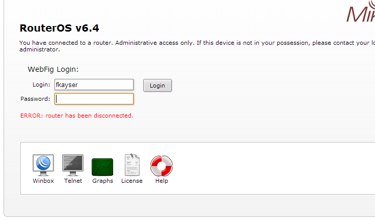

Since ROS 6.1 I’ve tried to get RADIUS Authentication working on WebFig.
The RADIUS Authentication is working for ssh and telnet, but when I’m trying to access the MT via WebFig, the CLI gives me the following message:
echo: system,info,account user fkayser logged in from 192.168.0.1 via web.
but the browser is showing for a short time the “Loading screen” and then I get the following message:
ERROR: router has been disconnected.
The Problem still exists in 6.4.
Like I said, RADIUS authentication via SSH or Telnet is working, so my config should be correct
Do I need to specify something special in order to get RADIUS authentication working with WebFig, or is there a Bug?

09:04:29 system,info,account user pruebaigj logged in from 192.168.92.13 via web
[admin@CPE] > user active print
Flags: R - radius, M - by-romon
WHEN NAME ADDRESS VIA
0 jul/19/2017 08:52:47 admin 192.168.92.13 web
2 R jul/19/2017 09:04:29 pruebaigj 192.168.92.13 web
Ditto. Stumped to see CHAP2 has been thrown into the mix too now :open_mouth:
Needless to say, webfig shall never be used then. Not prepared to change massive architectures to just accommodate something like this. MT needs to get with the program.
I’ve been able to solve the issue, I can login via web and ssh with ActiveDirectory and FreeRadius. I can share the config if someone have problems.
What about WinBox? Web and SSH use PAP authentication because the client but Winbox uses CHAP, which requires the AAA server to have access to the cleartext password. (Maybe Windows’s password encryption is reversible, but I would doubt it - I’m not a sysadmin so I can’t say for sure).
If Winbox can hit a Mikrotik utilizing AAA based on AD (no FreeRadius) then I’d be interested to see the Mikrotik-side configuration.
Windows can store the passwords using “reversable” encryption. It’s very possible to do, but 1) it’s not secure, and 2) it still doesn’t help anyone one bit that does NOT use AD, and do NOT have passwords available in clear-text.
IMHO, All AAA services should support PAP AND CHAP, and that’s it. I doubt WebFig makes use of ANY of the enhanced functionality that CHAPv2 provides in any case.
Apologies for reviving an old thread… but it’s almost mid 2018, we’re on 6.42.1, and RADIUS-based WebFig login still does not work. My RADIUS server is sending all the right replies. Log shows:
Message		RADIUS:     MS-CHAP2-Success = 0x00533d35443744314535453536393636
Message		user test.user logged in from 10.20.0.100 via web
Every time I do a login attempt, one more session is added to the Active Users tab, with an “R” to signify RADIUS:
radius	not by romon
Name		test.user
At		Apr/25/2018 19:15:09
From		10.20.0.100
By RoMON
Via		web
Group		full
Sessions keep piling up and they never seem to end.
I would much rather Mikrotik just disable this altogether, rather than make us “play” with it every time an update comes along, just to see if it got fixed.
I recommend that you contact support@mikrotik.com directly. I can log user into Webfig without any problems by using RADIUS services.
