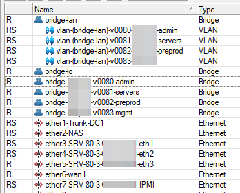

I use Trunk at Ether1 with vlan 80,81,82,83 - easy for now.

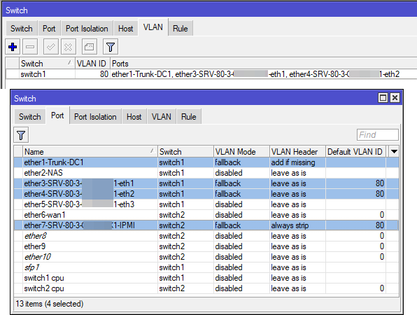

Ether3,4 both are Hybrid (Trunk 81,82,83 and 80 as Untagged ) by switch menu and fallback.
How add AccessPort from ether7 who is on separate switch-chip-2 ??
RB2011 not support “Bridge VLAN Filtering” and I cannot setup vlans in new way like (third generation of vlan configuration).

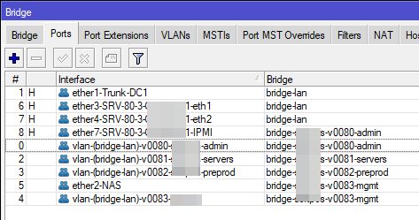

Interfaces with Bridge and vlans
Bridge Ports work well as 81,82,83 to manage them only as Trunk/AccessPort, not as Hybrid.
In this setup point of time the ether7 works because a software bridge port connect it but it’s not work as Hybrid :frowning:
Hybrid on Ether3,4 done in Switch menu.
Now the Server untagged traffic works as PVid 80 but the ether7 from second switch chip stop working.
I cannot access only that traffic from Ether7 who should work.

Solution 1) Two software Bridge and routing between them.
Cannot be done because I use the same network, this breake adressation etc.
Solution 2) Connect switch1 and switch2 by cable as Trunk
This is some of a way of workaround but insted that better will be add other Manged Switch to Gb swith1 and that way do better workaround.

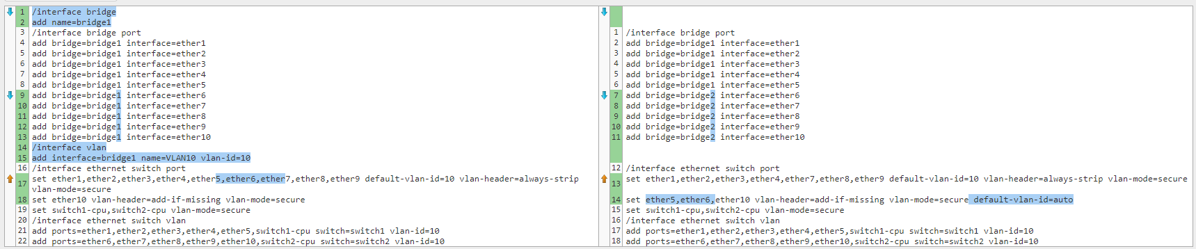

Diffrence of configuration is show here, ether 5,6 used as wire-trunk between switch-es who connect two separate software bridge1 and bridge2
