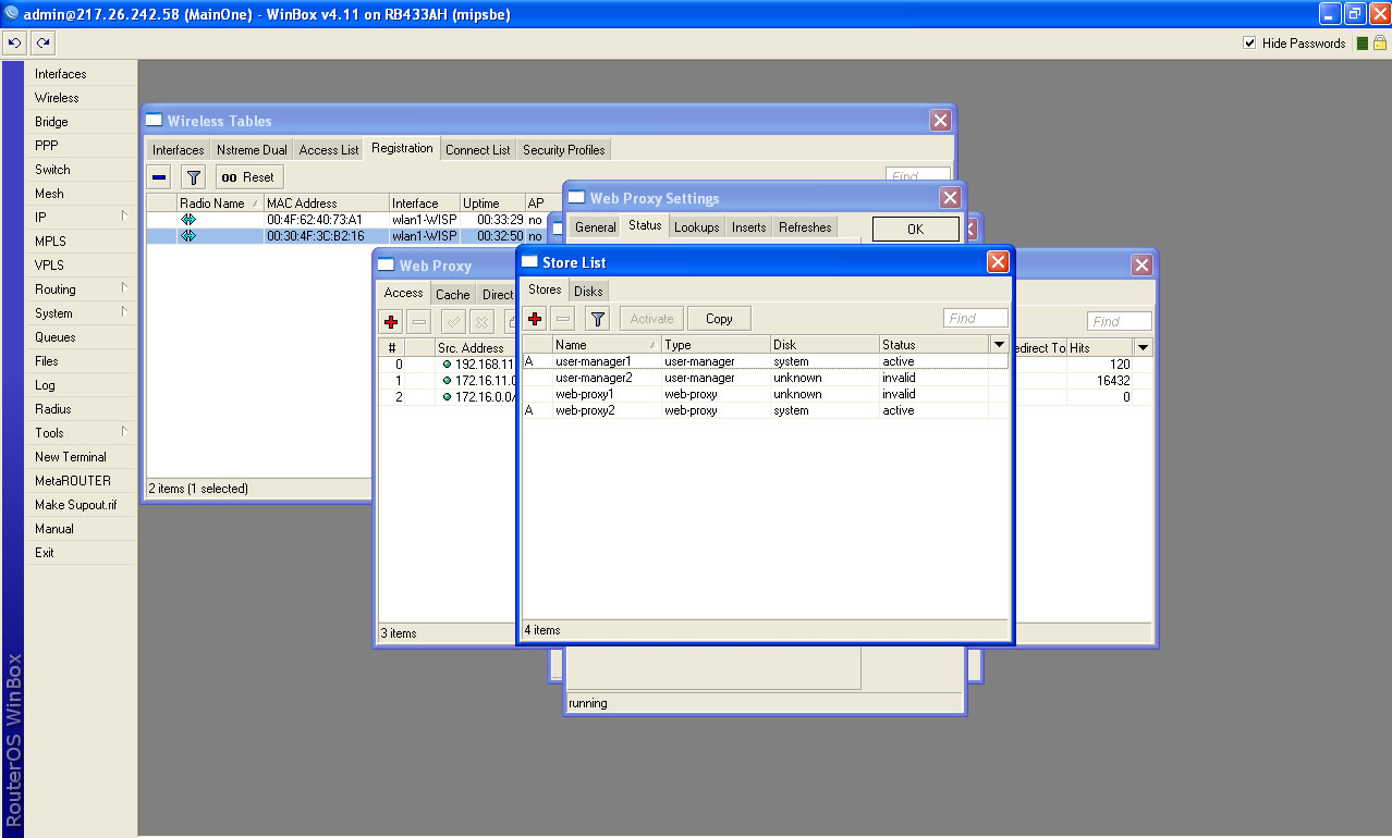

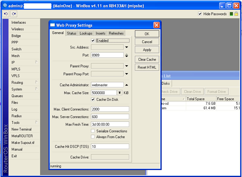

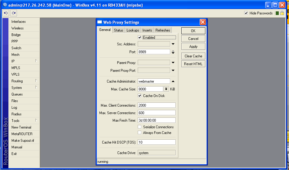

I have running web-proxy of RB433AH and storage is on a 8GB micro-sd card. It is formated with 7.6GB available space for use. my confirguration is for 5,000,000KiB of data space to be used for web-proxy. Sometime, when i check on stores, the storage media are not shown. When I check on the web-proxy settings, I will notice that it is kind of reconfigured to store web-proxy to system and also there will be a new web-proxy setup(web-proxy2) with 8000 storage limit instead of web-proxy1 which was configured. Can someone let me know what is wrong.

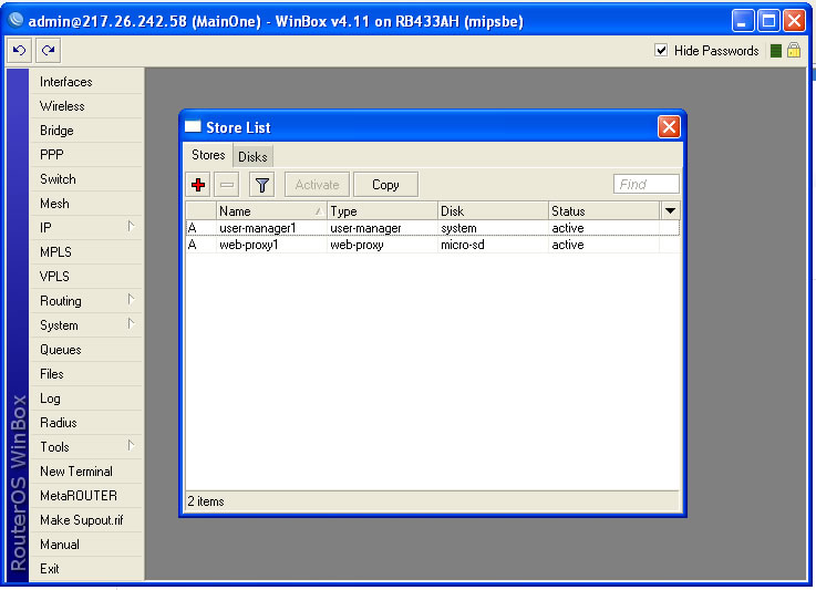

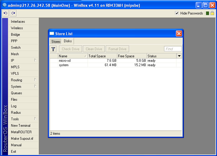

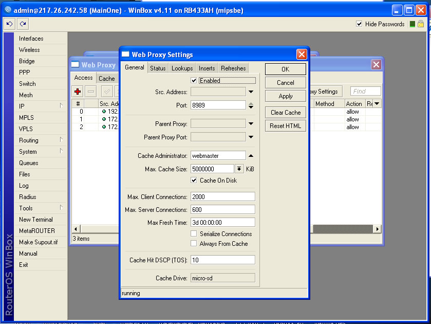

This is screen shot when things are normal
Please advise on what to do.

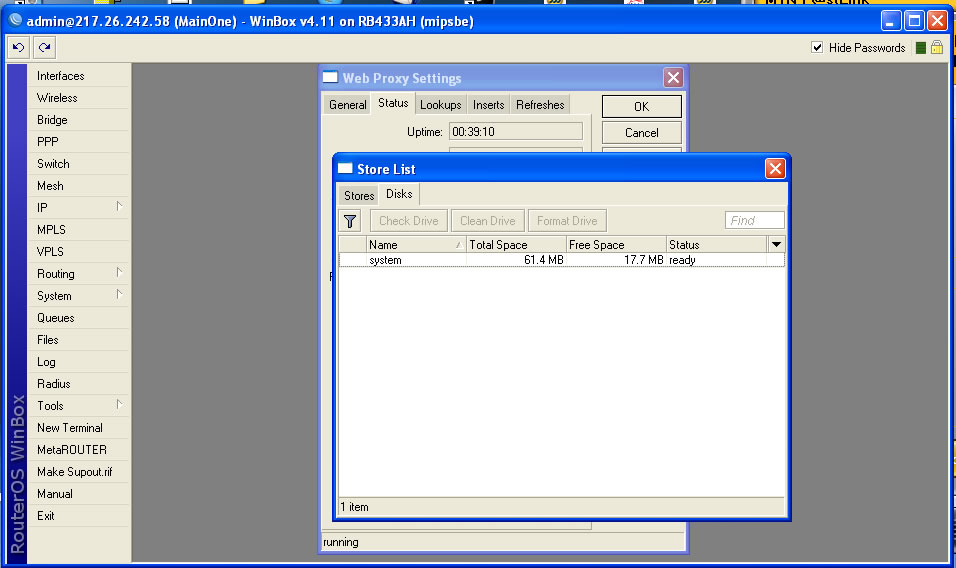

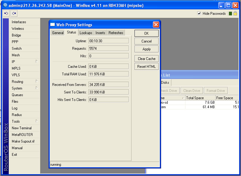

Check out the screen shorts
Please I need urgent assistance on how to solve this problem.
I have uploaded the screen shots.
