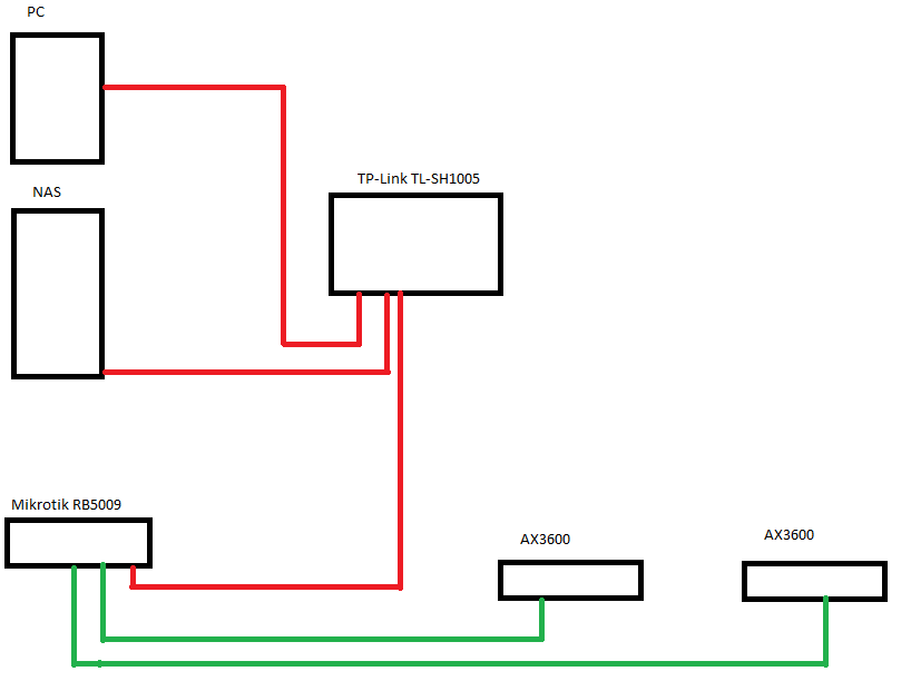

I have a dumb 2,5Gbe switch connected to RB5009’s 2,5Gbe port. Apart from RB5009, NAS and PC are connected to this switch which allows me to transfer files between PC and NAS quickly as well as to uzilize 2Gbe downlink from my ISP which is provided using SFP module. That portion of the network works flawlessly and I can utilize full internet speed on both NAS and PC as well as transfer files at >1Gbe speeds between them (HDDs in NAS are limiting factor).
Problem starts with two Xiaomis AX3600 which are flashed with openWRT and wired directly to 1Gbe ports of my RB5009. And this one is really strange. If I connect anything to AX3600 using ethernet cable - no problems there. I can see 1gig troughput from NAS and internet downlink. But as soon as I switch to WiFi that no longer is the case - I still can do speedtest @ 1Gig speed (AX3600’s are capable of 1,3-1,7Gbe wireless while copying from two sources to overcome 1Gbe link limit), but transfer from NAS is limited to ~400Mbps. As soon as I remove 2,5Gbe advertisement on RB5009’s eth1 port, transfer speed goes up to 1Gbe, which can be observed on this screen recording:

To me it looks like I discovered some bug in ROS, but I cannot figure out how to troubleshoot it further. I used two 2,5Gbe switches based on different platforms (Realtek and Broadcom): TP-Link TL-SH1005 and QNAP QSW-1105T-5T. I have RB5009UPR+S+IN running latest ROS stable - 7.11.2. I also attached simple diagram to help visualize my network setup. If some configuration files are needed, I will happily provide them.

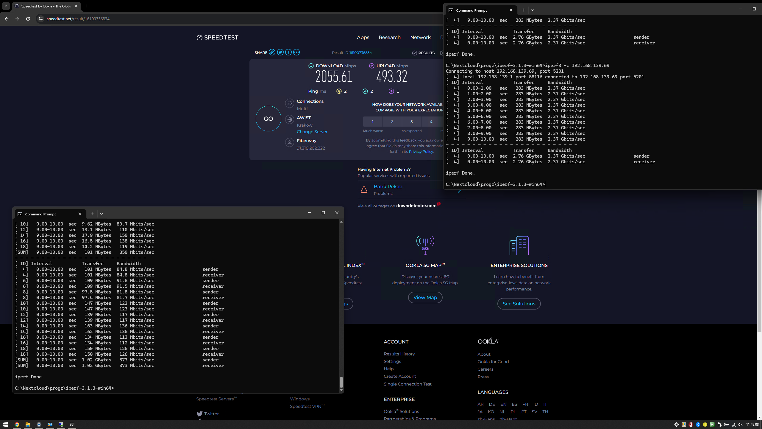

Wow! Thank you @CoMMyz! Disabling HW offload for this one port completely resolved this issue. I am able to saturate my 2Gbit connection from ISP while maintaining ~1Gbit transfer rate using wireless!
Attached screenshot might be confusing, because it shows two Command Prompt windows from different machines (thanks to RDP). The one on top skips RB5009 altogether since that’s traffic between PC and NAS connected using switch, but as you can see my connection to internet remains 2Gbit and - most importantly - my wireless still manages to push almost 1Gbit.
I cannot tell difference when it comes to CPU usage on RB5009. Both before and after disabling HW offload it’s ~30% when transferring between WAN and LAN @ 2Gbit speed.

That’s because vast majority of CPU resourdes are used for firewalling, some for routing and only minor portion for interface handling (bridging).
But I wonder if your case falls into same category as other cases in this thread. Others are using RB5009 as switch between 2.5GbE and 1GbE ports where both ports are members of same bridge and HW offload can kick in. If 2.5GbE port is used as WAN, then it’s usually off-bridge and L2 HW offload doesn’t work.
