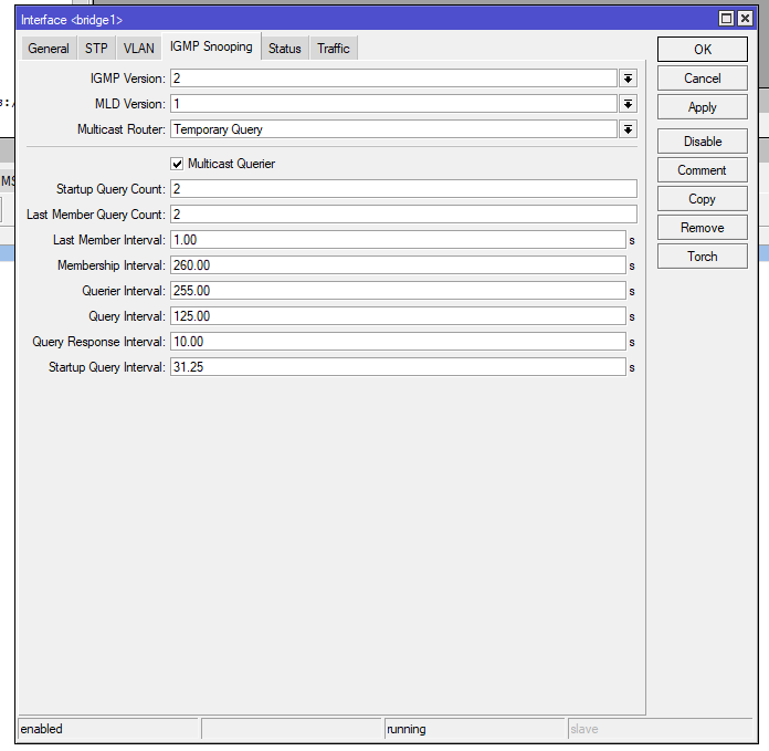

Hi, I had a similar problem on my RB5009, multicast stopped working after about 5 minutes then I had to call the multicast query again. I solved this problem by enabling “Multicast Querier” on the bridge. After this procedure it started working correctly. I was previously using RB760 and did not have this option enabled and it worked fine.
