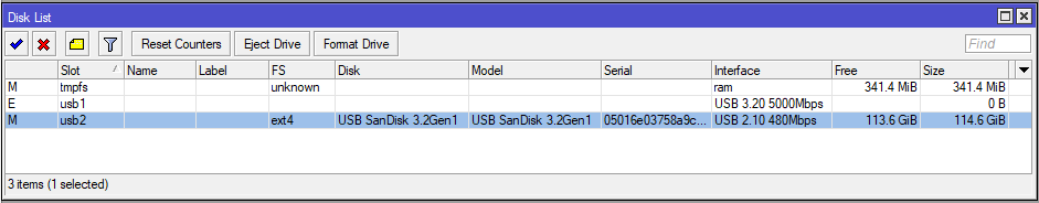

I have just bought a new MikroTik RB5009 a few days ago, updated to the latest stable version 7.7, and I have a problem when using a USB drive (specifically a SanDisk Ultra Fit 3.1 64GB formatted in ext4 from within the router).
In the System/Disks menu I see two usb interfaces: USB 3.20 5000Mbps (slot “usb1”) and USB 2.10 480Mbps (slot “usb2”) (see attached screenshot).
The problem is that every time I reboot the router, the drive seems to alternately connect to a different interface, so it mounts either on usb1 or usb2, and the containers don’t work when it gets mounted on the usb2 slot.
Is this behavior normal? Is there a way to force the drive to always mount on slot1 using the faster usb 3.2 interface?

reply-ing to an old post, but did you in the meantime found a proper fix for this issue ? I’m suffering from the same :frowning:
I found another thread on this forum about the same: http://forum.mikrotik.com/t/rb5009-routeros-7-9-1-usb-slot-keeps-changing/167185/1 but that also doesn’t seem to have a proper solution.
Already tried 7.13 ?
Yes, I’ve installed 7.13 ros and firmware on all my boards, issue is still there.
I got reply yesterday from support on my ticket that they have confirmed the issue specifically with SanDisk USB sticks.
They are looking for a solution.
