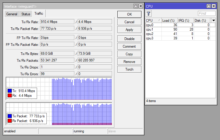

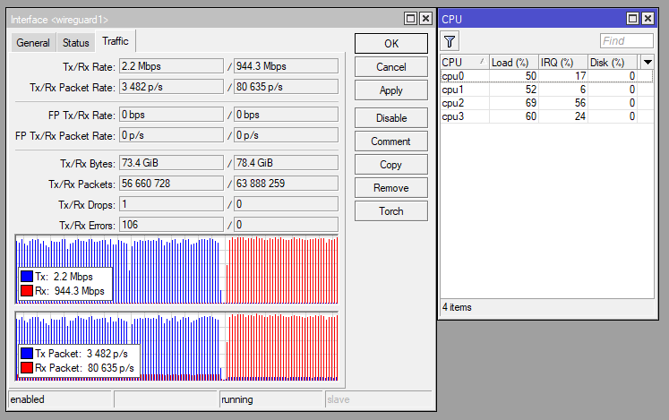

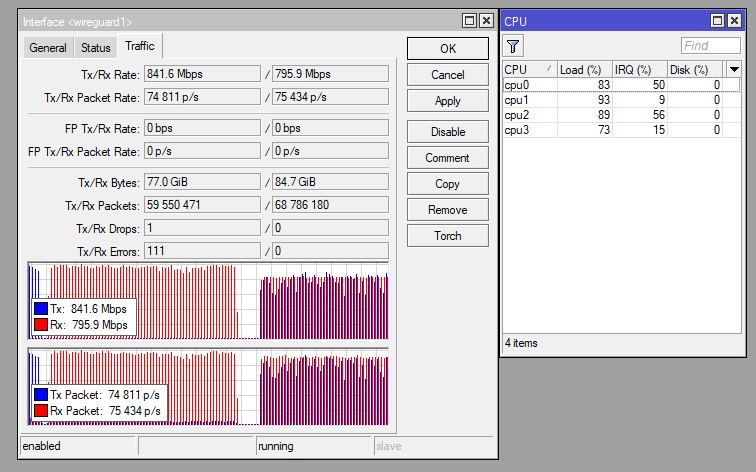

Regarding RB5009 and WireGuard, RB5009 can do a little more than 150Mbps:

Znevna’s Wireguard througput measurements is what one would expect regarding the RB5009 CPU number crunching power.
