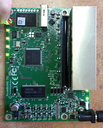

UPD: Ok, took the case off, shorting reset hole gives nothing - all leds re ON.

unfortunately contact your reseller to arrange RMA
