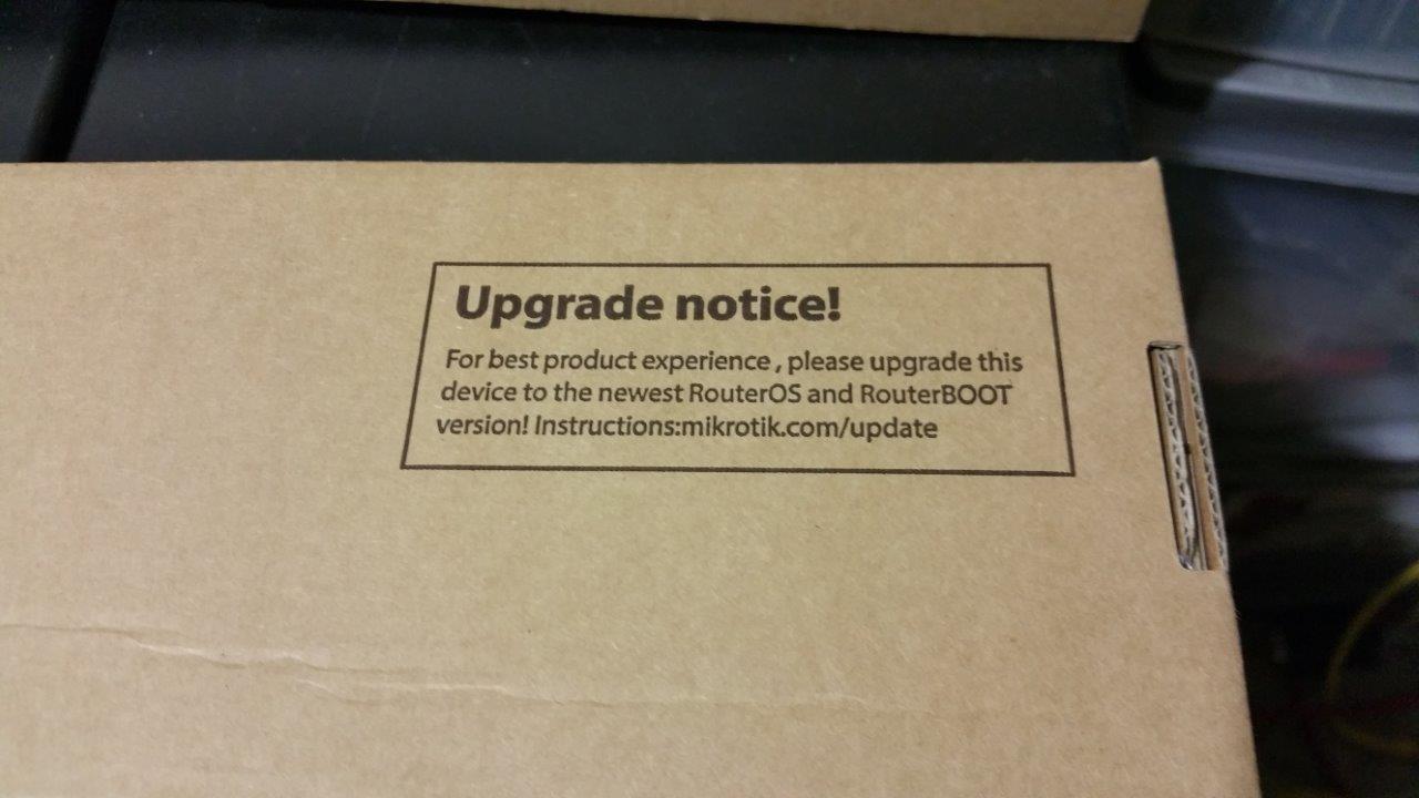

b) Bottom of the box has Upgrade Notice, to update RouterOS and RouterBOOT. WinBox does not have it listed in Neighbors, no IP assigned to my workstation by DHCP, static IP of 192.168.88.2/24 can not ping nor connect to 192.168.88.1 port 80. How do I update this thing?
Am I missing something simple?

The software upgrade notice, even though it says to “please upgrade this device to the newest RouterOS and RouterBOOT version” this can’t be done. There is no accessable interface.
The upgrade notice should be ignored, and shouldn’t be there in the first place.
