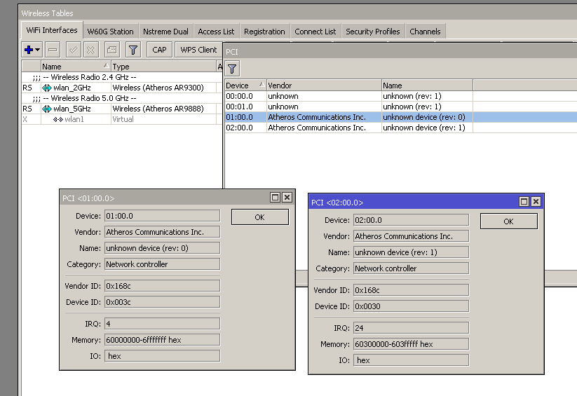

It’s true,I have test two WiFi card work at once on RBM33G at July 2019, and the
Cards can work on caps mode
which cards are you using ?
I’ve tried a R11e-2HPnD and R11e-5HacT.
But together they won’t work. After a couple of days the board freeze.
Ony with one of the cards it works well (RBM33G with 128GB M.2 and USB LTE Modem)

Using two PCIe cards or USB based (LTE modems) are supported, but there are some limitations.
To use two LTE modems - USB lines has to be switched by removing jumper near USB port.
If two pcie (wireless) cards needs to be used - there are some limitations to bus speeds that may cause performance issues at high speeds. That is the reason why use of two PCIe (wireless) cards simultaneously is not recommended. If both cards are two chain or less, or are not under 100% load all the time - they should work.
