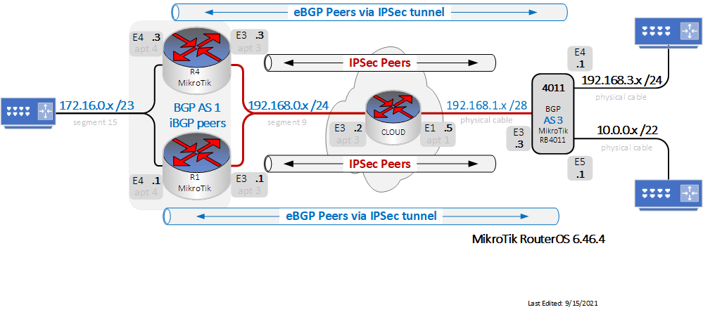

Attempting to enable redundancy or at lease dynamic failover with my limited infrastructure (lab mock-up of actual environment in pic below).
Goal:
I would like my single router at Site-A (4011) to form IPSec tunnels with my two 2 routers at Site-B (R1 & R4) simultaneously .
I would also like to encrypt 2 of my networks at Site-A (192.168.3/24 & 10/22) when Site-B is the destination (172.16/23).
My Question:
Is this a valid implementation with MikroTik RouterOS? And if so, is there a solution?
Site-A (4011)
Single MikroTik router RB4011
LAN 192.168.3.0 /24
LAN 10.0.0.0 /22
WAN 192.168.1.0 /28
Site-B (R1 & R4)
2 MikroTik routers, both connect and share same LAN and WAN network segments; see pic.
Site-A (4011)

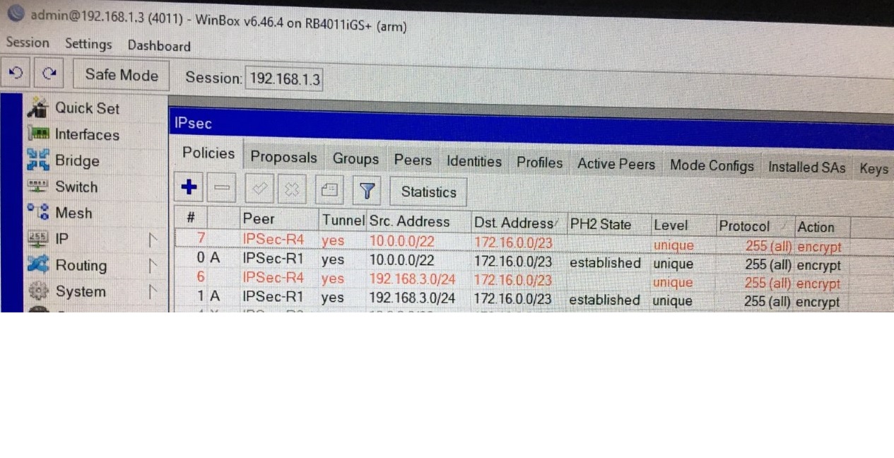

On Site-A (4011)
IPSec Policy for peer R1 192.168.0.1 becomes established and passes traffic.
IPSec Policy for peer R4 192.168.0.3 fails to become established.
If remote peer R1 goes off-line, 4011 peer R4 Policy remains red and doesn’t pass any traffic although there are SAs for R4 but no SPI for this peer.
Flushing SAs multiple times doesn’t help.
If I manually disable R1 policies on 4011, R4 and 4011 become established immediately and are able to pass traffic.

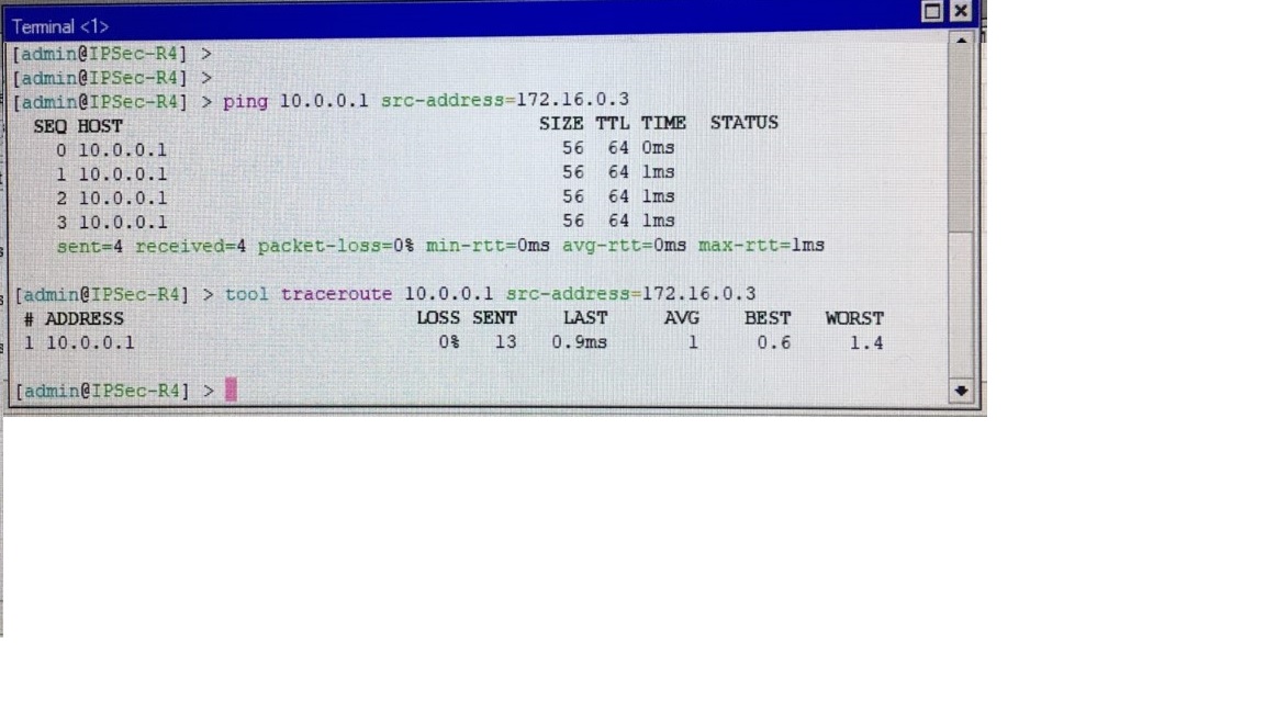

In my LAB environment … we are operational!! That was real fun. :slight_smile:
To get this operational I started with MikroTik to MikroTik peering - topology in original message.
In this implantation, eBGP peers through the GRE tunnel which is IPSec encrypted across the WAN (policy encrypts the GRE tunnel src/dst pairs). BGP announces my selected LAN prefixes and works well to block unwanted prefixes. LAN destinations are reachable from remote at both ends and this data traffic is verified encrypted (as-well-as all other traffic) via the Cloud (simulated Internet) router packet sniffer and Wireshark. Sadly, I am only using PSKs for now.
Now that this is an operational LAB environment, I will add the other vendor and work through any issues.
