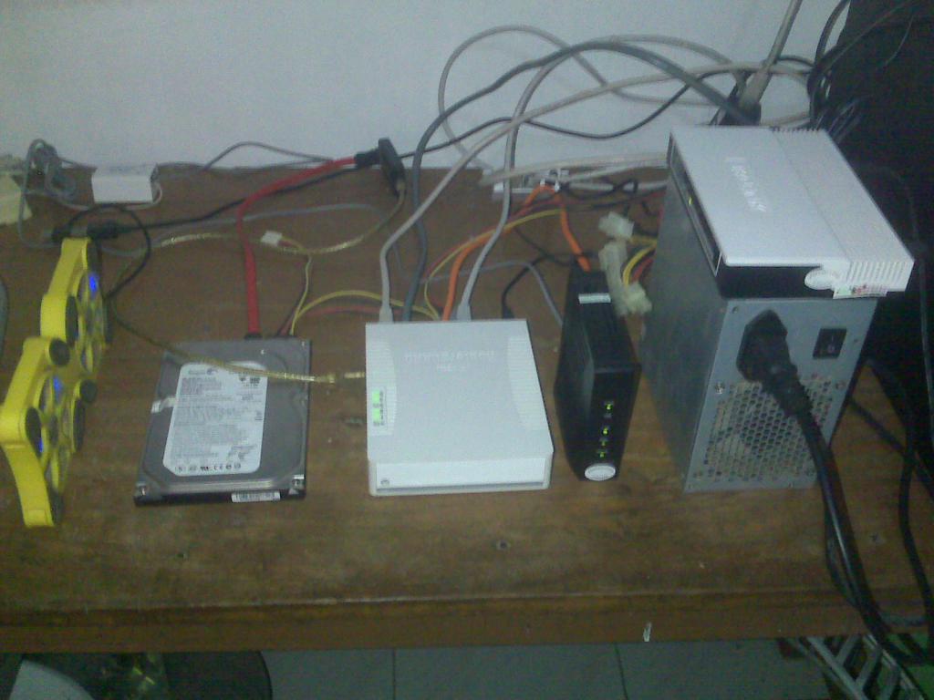

i have rb751u-2hnd, i plan to connect to usb port with usb modem and usb hdd for proxy. it’s reliable?thanks
