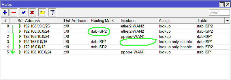

Hi all,
Just upgraded my hEX from v6.49 to v7.5 and found it is little bit different regarding dual ISP handling.
I’ve read routing tutorial here https://help.mikrotik.com/docs/display/ROS/Routing and also some other examples on Youtube, but still don’t get the basic concept of routing rules. Here some silly questions:
  1. Does routing rules applied sequentially? (see picture above)
  2. If I don’t use mangle, how do I get “Routing Mark”? In this tutorial https://help.mikrotik.com/docs/display/ROS/Policy+Routing its said that “It is not recommended to use both methods (mangle and rules) at the same time or you should know exactly what you are doing.”. To be honest, I don’t know what should I do :confused:
  3. If I access MK from WAN trough pppoe-WAN1, do I still need mangle to mark my connection?
I tried some examples to make Policy Based Routing works in RoS v7.5 as I did in RoS v6, but I feel not satisfied with the result. I also tried PBR + failover + recursive routing without success. So, now I have only applied PBR on my hEX.

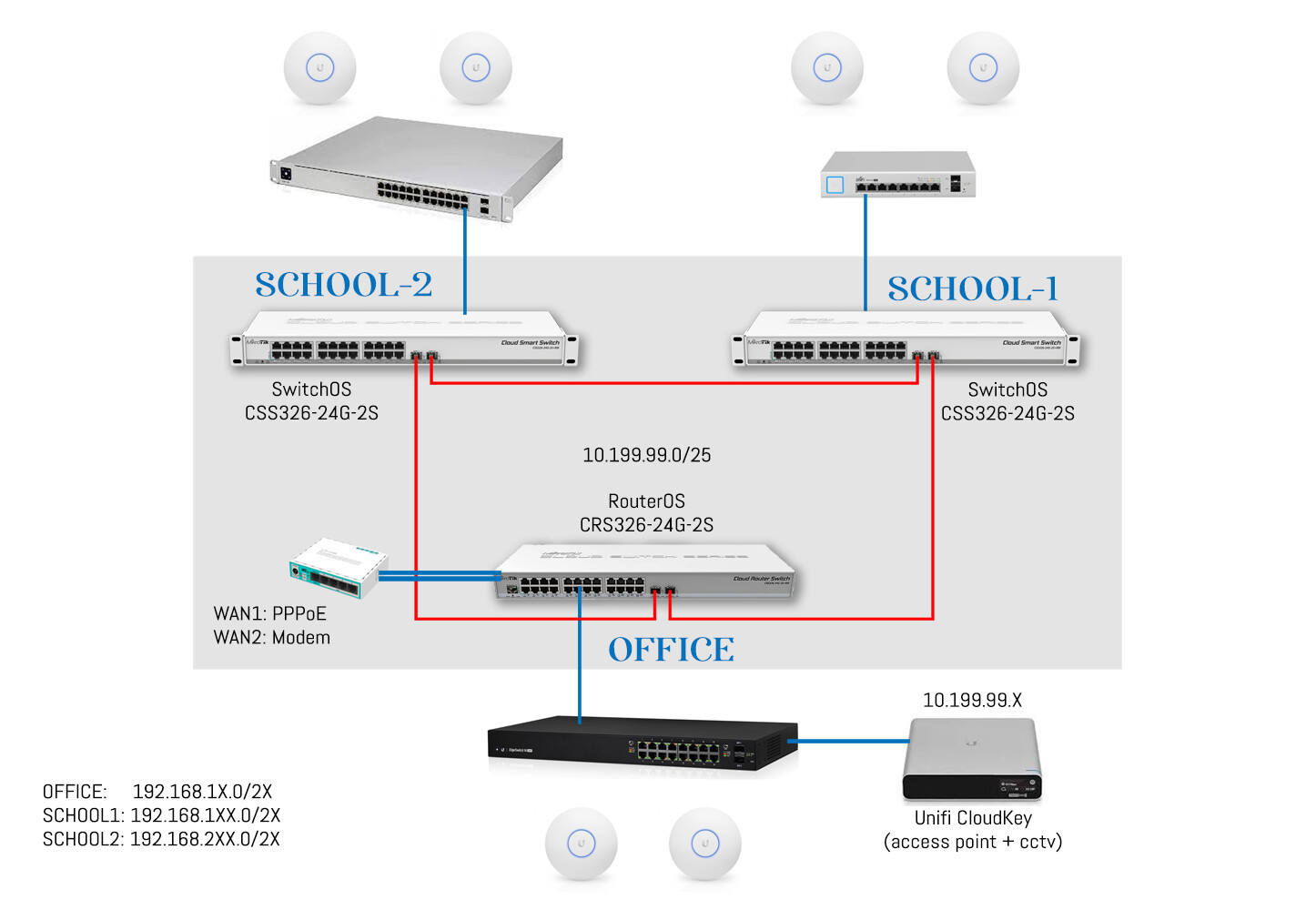

Here my RouterOS v7.5 setup on hEX RB750Gr3. This RB router connected directly to CRS326-24G-2S+ as the main switch-router.

/routing rule
add action=lookup disabled=no dst-address=::/0 interface=ether2-WAN2 src-address=10.199.99.0/25 table=rtab-ISP2
add action=lookup disabled=no dst-address=::/0 interface=pppoe-WAN1 src-address=10.199.155.0/24 table=rtab-ISP1
add action=lookup disabled=no dst-address=::/0 interface=pppoe-WAN1 src-address=192.168.10.0/24 table=rtab-ISP1
add action=lookup disabled=no dst-address=::/0 interface=pppoe-WAN1 src-address=192.168.100.0/24 table=rtab-ISP1
add action=lookup disabled=no dst-address=::/0 interface=pppoe-WAN1 src-address=192.168.110.0/24 table=rtab-ISP1
add action=lookup disabled=no dst-address=::/0 interface=pppoe-WAN1 src-address=192.168.200.0/24 table=rtab-ISP1
add action=lookup disabled=no dst-address=::/0 interface=pppoe-WAN1 src-address=192.168.210.0/24 table=rtab-ISP1
add action=lookup disabled=no dst-address=::/0 interface=ether2-WAN2 src-address=192.168.20.0/24 table=rtab-ISP2
add action=lookup disabled=no dst-address=::/0 interface=ether2-WAN2 src-address=192.168.30.0/23 table=rtab-ISP2
add action=lookup disabled=no dst-address=::/0 interface=ether2-WAN2 src-address=192.168.120.0/22 table=rtab-ISP2
add action=lookup disabled=no dst-address=::/0 interface=ether2-WAN2 src-address=192.168.220.0/22 table=rtab-ISP2
add action=lookup disabled=no dst-address=::/0 interface=ether2-WAN2 src-address=172.23.45.0/23 table=rtab-ISP2
add action=lookup disabled=no dst-address=::/0 interface=ether2-WAN2 src-address=172.27.89.0/23 table=rtab-ISP2
add action=lookup disabled=no dst-address=::/0 interface=ether2-WAN2 src-address=172.17.77.0/24 table=rtab-ISP2
add action=lookup disabled=no dst-address=::/0 interface=ether2-WAN2 src-address=172.18.18.0/24 table=rtab-ISP2
add action=lookup disabled=no dst-address=::/0 interface=ether2-WAN2 src-address=172.19.19.0/24 table=rtab-ISP2
add action=lookup-only-in-table disabled=yes dst-address=::/0 routing-mark=rtab-ISP2 src-address=172.16.0.0/12 table=rtab-ISP2
add action=lookup-only-in-table disabled=yes dst-address=::/0 routing-mark=rtab-ISP1 src-address=192.168.0.0/16 table=rtab-ISP1

This configuration works for now. But.. not perfect. If I disable all backup route (distance=2), all VLAN got no internet. So, it’s seem the routing rule did not stores data into rtab-ISP1 or rtab-ISP2, only in main table.
#disable distance=2
add comment="WAN2 (backup main table)" distance=2 ... disabled=yes
add comment="WAN1 (backup main table)" distance=2 ... disabled=yes
Thank you
Hi there, so let me understand this correctly.
The router connected to the internet is the CRS ?
The hex is behind the CRS and not connected directly to the internet.
IF so what is the purpose of the hex? Do you need it to do routing or just switching?
hEX connected to internet
CRS for internal switching
Here the network layout. CRS as a root bridge connected to 2 CSS switches in other buildings using SFP+ port in this ring topology.
I’ve tried connected internet directly into CRS and make it as main router, but this device seem not suitable for routing and WAN (CPU load was high and I run out of disk). So I added hEX to this network.
Awesome, now one needs to know the requirements or in your case how you expect to use the WAN connections.
For example.
a. wan1 primary and wan2 secondary
b. load balanced PCC
other less frequent options are
c. wan1 primary and wan2 secondary but some user, groups of users, or subnet should use WAN2
d. one school uses wan1 and one school uses wan2, with failover in case one of the wans goes down.
a. WAN1: classroom, teacher, staff, PCs/laptop, some server (computer stuff) (VLAN5, VLAN10, VLAN100, VLAN110, VLAN200, VLAN210).
b. WAN2: all student, most handphone devices, guest (VLAN20, VLAN30, VLAN120, VLAN220, VLAN345, VLAN789, VLAN_MGMT/99)
If WAN1 is down WAN2 as backup/failover, and vice versa.
Thank you
add action=lookup disabled=no dst-address=::/0 interface=ether2-WAN2 src-address=172.19.19.0/24 table=rtab**-ISP2**
(11) ROUTES amended… (will assume above routing rules added in error). REMOVE ANY mangle rules… not required as far as I can see.
add comment=“WAN1 (directed to WAN1 Table: rtab-ISP1)” disabled=no distance=1 dst-address=0.0.0.0/0 gateway=pppoe-WAN1 pref-src=“” routing-table=rtab-ISP1 scope=30 suppress-hw-offload=yes target-scope=10
add comment=“WAN2 (directed to WAN2 Table: rtab-ISP2)” disabled=no distance=1 dst-address=0.0.0.0/0 gateway=10.2.2.1 pref-src=“” routing-table=rtab-ISP2 scope=30 suppress-hw-offload=yes target-scope=10
add comment=“WAN2 (main table available WAN2)” disabled=no distance=1 dst-address=0.0.0.0/0 gateway=10.2.2.1 pref-src=“” routing-table=main scope=30 suppress-hw-offload=yes target-scope=10
add comment=“WAN1 (main table available WAN1)” disabled=no distance=1 dst-address=0.0.0.0/0 gateway=pppoe-WAN1 pref-src=“” routing-table=main scope=30 suppress-hw-offload=yes target-scope=10
/routing rule
add action=lookup disabled=no  src-address=10.199.155.0/24 table=rtab-ISP1  comment=Streaming-VLAN_5
add action=lookup disabled=no src-address=192.168.10.0/24 table=rtab-ISP1  comment=Office-VLAN_10
add action=lookup disabled=no src-address=192.168.100.0/24 table=rtab-ISP1  comment=JH-VLAN_100
add action=lookup disabled=no  src-address=192.168.110.0/24 table=rtab-ISP1  comment=JH-Teacher-VLAN_110
add action=lookup disabled=no src-address=192.168.200.0/24 table=rtab-ISP1  comment=SH-VLAN_200
add action=lookup disabled=no  src-address=192.168.210.0/24 table=rtab-ISP1 comment=SH-Teacher-VLAN_210
add action=lookup disabled=no src-address=10.199.99.0/25 table=rtab-ISP2  comment=Management-VLAN_99
add action=lookup disabled=no src-address=192.168.20.0/24 table=rtab-ISP2  comment=Office-VLAN_20
add action=lookup disabled=no src-address=192.168.30.0/23 table=rtab-ISP2  comment=Office-VLAN_30
add action=lookup disabled=no  src-address=192.168.120.0/22 table=rtab-ISP2  comment=JH-Student-VLAN_120
add action=lookup disabled=no  src-address=192.168.220.0/22 table=rtab-ISP2  comment=SH-Student-VLAN_220
add action=lookup disabled=no src-address=172.23.45.0/23 table=rtab-ISP2  comment=Guest-Office-VLAN_345
add action=lookup disabled=no src-address=172.27.89.0/23 table=rtab-ISP2  comment=Guest-School-VLAN_789
If you were doing this recursively, I THINK, not 100% certain, it could look like this for IP routes:
add check-gateway=ping distance=2 dst-address=0.0.0.0/0 gateway=1.0.0.1 scope=10 target-scope=12
add distance=2 dst-address=1.0.0.1/32 gateway=ppoe-WAN1 scope=11 target-scope=11
add check-gateway=ping distance=2 dst-address=0.0.0.0/0 gateway=9.9.9.9 scope=10 target-scope=12
add distance=2 dst-address=1.0.0.1/32 gateway=10.2.2.1 scope=11 target-scope=11
add distance=2 dst-address=0.0.0.0/0 gateway=pppoe-WAN1 routing-table=rtab-ISP1
add distance=2 dst-address=0.0.0.0/0 gateway=10.2.2.1 routing-table=rtab-ISP2
In this version, the router checks to see if WAN1 is available through DNS server from cloudfare
and checks to see if WAN2 is available through quad9.
This is done typically because it does happen where the gateway and the ISP is available from the ROUTER side, but the ISP is having issues and not connected itself to the WWW.

:slight_smile: :slight_smile: this is what I’ve got so far. The first vlan setup, the first bonding setup, the first switchos setup. I’m familiar with Unifi for several years and Mikrotik for 2 years. Only familiar, not a network veteran. As a teacher, we love learning.
Ether5-backup used as main port to CRS before I found that 802.3ad (LACP) the most suitable for portBond_3-4. I’ve try several other mode and use ether5 ( if something bad happen) as a backup. As your suggestion, I’ll convert it to emergency access.
I’ve not managed to make vlan99 works on UniFi SSID (I’ve got no ip address when I choose vlan99 as network access point). Sometime I need access (i.e. to Unifi Controller) while I’m off the office or walking around at other building, then I setup hidden SSID using vlan5. Until I’ve managed proper configuration between CRS → EdgeSwitch → Unifi Controller, I use vlan5 as backup to access the devices.
Have no specific reason. I read somewhere that MSTP has backward compatibility with RSTP, and the EdgeSwitch also support MSTP.
(to be continued)
For UNIFI, they are a strange breed and in defaut expect the managament vlan to be untagged and the data vlans tagged, vice all tagged.
In other words tthey requirea hybrid port coming into the unifi vice the more standard trunk port.
So whatever switches you have directly connected to the UNIFI,
the port to any unifi AP will have to be hybrid, vlan99 untagged on the port and any other vlans tagged on the port.

  1. I moved one Unifi AP to different subnet (192.168.10.10, vlan10) and try to adopt it from Unifi Controller (10.199.99.10, vlan99) but failed;
  2. Trying to ping the AP (192.168.10.10) from my PC (10.199.99.30, vlan99) also failed-> Request timed out;
  3. Trying to ping the AP (192.168.10.10) from RouterOS (10.199.99.1, vlan99) → Succeed;
  4. Add firewall filter to give vlan99 all access to to other vlans, still failed → Request timed out;
  5. Fastrack disabled, then add NAT to Unifi Controller (10.199.99.10, vlan99), still failed → Request timed out;
  6. Add NAT to AP (192.168.10.10, vlan10), still failed → Request timed out;
  7. NATs deleted… looking for another options;
  8. Trying to add /IP/Route/ to both direction, still failed, route list removed → Request timed out;
  9. Looking into /Routing/Rules/ print:
;;; VLAN_99: MGMT
src-address=10.199.99.0/25 action=lookup table=rtab-ISP2
;;; VLAN_10: Office-1
src-address=192.168.10.0/24 action=lookup table=rtab-ISP1
  1. Trying to add new rule → Request timed out;
/routing rule
add action=lookup disabled=no  src-address=10.199.99.0/25 dst-address=192.168.10.0/24 table=main comment=Local-Routes
  1. Adding new rule → Succeed;
/routing rule
add action=lookup disabled=no  src-address=192.168.10.0/24 dst-address=10.199.99.0/25 table=main comment=Local-Routes
So, because the routing table moved to rtab-ISP1 or rtab-ISP2, then I need to manually add specific src-address and dst-address with the same routing table (main) in both direction. Is it the right way in RoS v7 to achieve this? Maybe we would not have this problem if we only have single WAN, but with dual WAN and changing routing table?
This solve the problem
/routing rule
Thank you
I even can not ping from any subnet to it’s own gateway:
  • ping 192.168.20.1 → request timed out (from 192.168.20.x)
  • ping 192.168.30.1 → request timed out (from 192.168.30.x)
So here the simplest solution with 3 lines of code:
/routing/rule/
add dst-address=10.0.0.0/8     action=lookup-only-in-table table=main comment=SUBNET
add dst-address=172.16.0.0/12  action=lookup-only-in-table table=main comment=SUBNET
add dst-address=192.168.0.0/16 action=lookup-only-in-table table=main comment=SUBNET
Place it above the rest.
Also watch your firewall filter!
