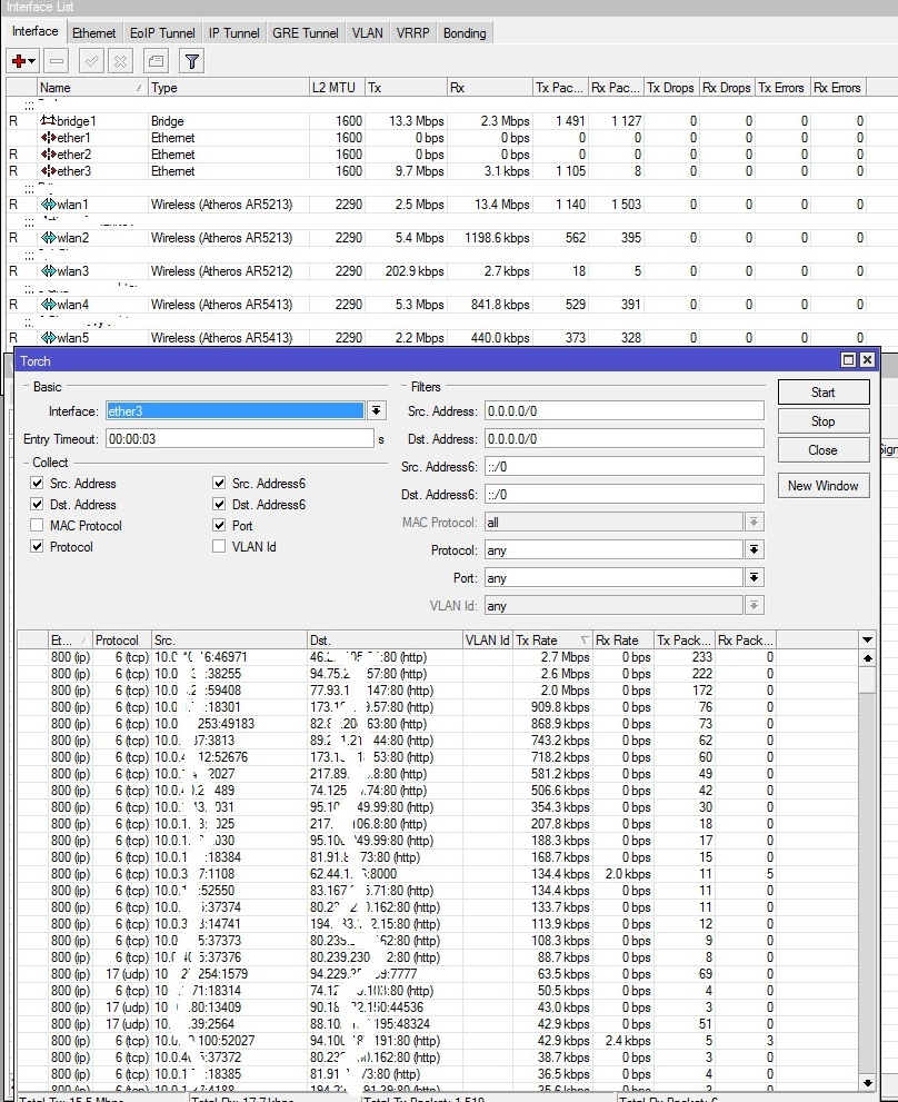

I attach a sample problem STATION BRIDGE mode.
Example:
wlan1 - WAN
eth3, wlan2, wlan3, wlan4, wlan5 - Bridge
Please look at ETH3! TX traffic, which according to the TORCH coming from the direction of wlan1, wlan2, wlan3, wlan4, wlan5 (by IP).
The abnormal traffic only comes from clients who have set station bridge mode!
If you turn off the client station bridge, traffic on eth3 falls down.
Makes me all the way to the AP.

Is the AP bridged, or are you doing routing, what is generating the traffic, the routerboard, or an
end user? and where is it going to? just random addresses?
very strange problem, loop traffic maybe? are you using default-forward on your
wireless interfaces?
yes WLAN1-5 AP-Bridge and AP are all in BRIDGE1.
For example, the user is connected to WLAN2. It is RouterBOARD STATION BRIDGE mode as soon to be 3 Mbps download from the Internet and will show the same data stream on ETH3, as shown in the picture. As if poorly directed. I tried to turn all RSTP but without result. When I turn off Station Bridge to client RouterBOARD so everything is fine.
Wireless client in the Access List and is allowed to forward
Abnormal Traffic will no longer appear on the upgrade version 5.4. Thank you!
