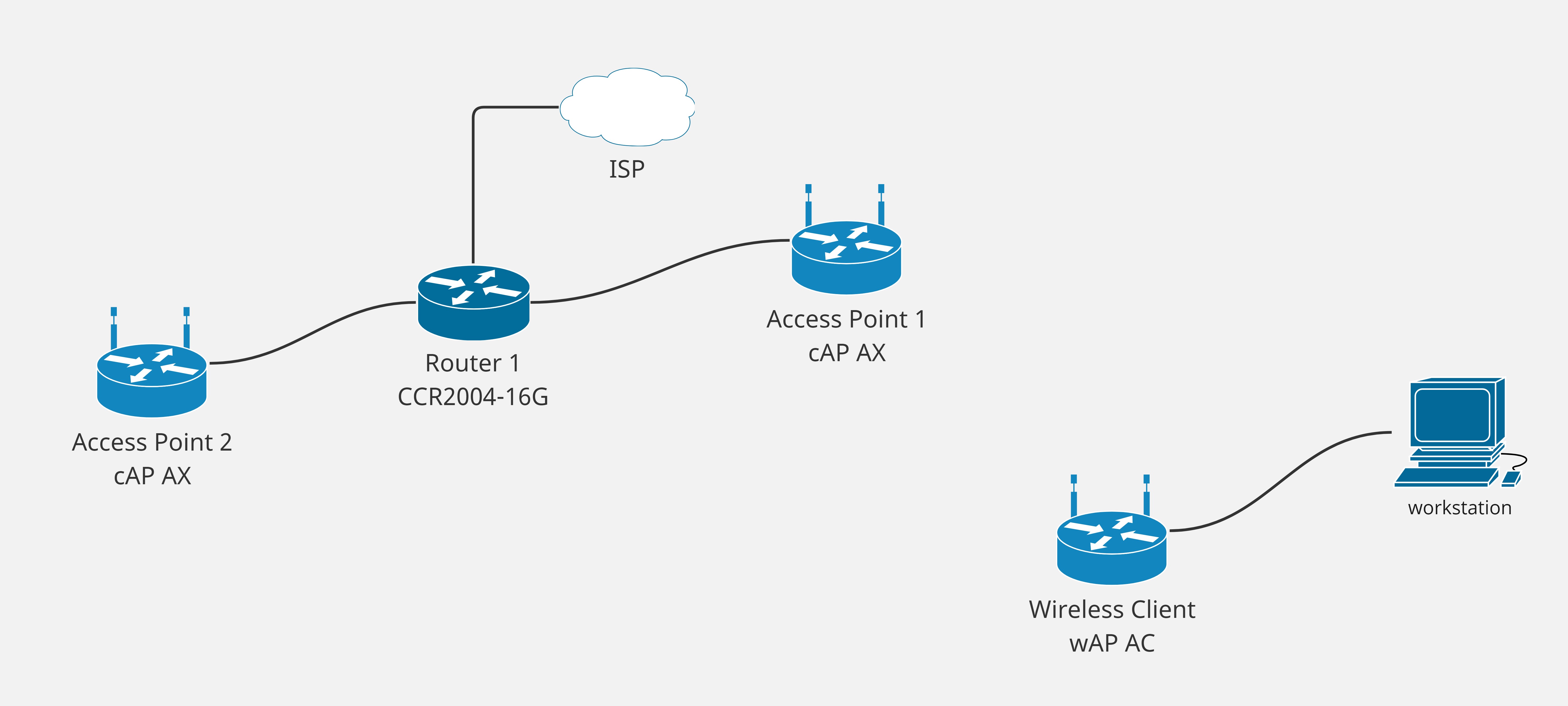

Ok, so I have an all-Mikrotik network here, pretty basic, just a core router and a couple access points. I would like to have a wireless client bridging a wired-only workstation to the network, layer 2, like so:
“workstation” is connected to the wAP AC via RJ45. wAP AC connects to Access Point 1 (cAP AX) via 5Ghz on channel 5805.
At the moment, this is all working via station-pseudobridge, but it sounds like that’s a compromise considering I have an all-Mikrotik network. How do I get this running via station-bridge? I have read the docs, and it sounds like there’s a bridging mode I need to enable on Access Point 1 (cAP AX), but I cannot find that mode, and the documentation around it in the CLI makes it sound like bridging mode will make Access Point 1 unavailable to other clients, which is no good (it’s a regular access point for many clients.
Has anyone seen a good document on this? Thanks

station-bridge does not work between “interface wifi” and “interface wireless”.
They need to be the same type. And as you have a cAP ax, it can only be “interface wifi”.
Ahh, makes sense. Can I use interface wifi on the wAP AC?
If you mean “RBwAPG-5HacT2HnD”, then unfortunately, it is not possible there.
Yep, that’s the one. Ok, makes some sense. Time to break out the wallet and upgrade, no biggie. Thanks all!
Yes, on the newer wAP AC models it can be done. You need the model with ARM processor, not the MIPSBE.
Of course there are also other workarounds to get working what you like, as discussed on the forum.
For bridge-type connections, it is better to use devices specially designed for this purpose.
Devices with directional antennas.
For example SXTsq 5 ac
