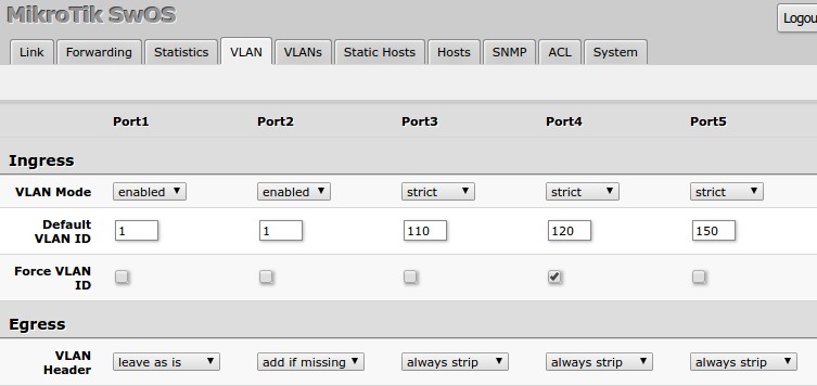

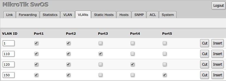

Here is my setup:
Connecting trunk to Port 1: test port I could access SwOS management IP but could not pass vlan traffic to access ports
Connecting trunk to Port 2: Trunk port, I could pass vlan traffic but not access the SwOS, which I of course worked around by placing SwOS management IP on one of the vlans. After many tests and much searching I have come to the conclusion that the setup I had planned (untagged management while passing vlan traffic to edge and other trunk ports) is not possible with SwOS.
