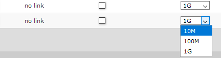

Unable to get 10G link working switch to switch the other switch I am using is CRS326-24G-2S+
If I disable auto-negotiation both sides and set the speed to 1G the link comes up on 1Gbps Speed.
Also There is no option to set the speed to 10Gbps after disabling auto-negotiation.
