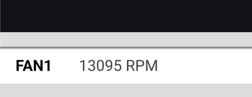

Hello guys, i have one CSS610 and two CRS310 devices. Because i already have the CSS610 with SwitchOS Lite and i found it very easy to use i wanted to use the 310’s with SwitchOS. So i upgraded SwitchOS 2.16 on my 310’s and rebootet both devices.
so i have flashed one passive CRS310-1G-5S-4S+OUT and one CRS310-1G-5S-4S+IN (active cooling with that small fan).
On the passive Outdoor its working fine but the CRS310-1G-5S-4S+IN is really noisy now because with SwitchOS the fan always turns at max speed (see attachment). So i had to revert it back to Routeros and it get’s quiet after the booting again. How can i use SwitchOS and have the fan controlled autmoatic - is it a bug that it turns max Speed with SwitchOS? Its not even running hot with ~33°C Board and 42°C CPU temps but fans run at maximum level.

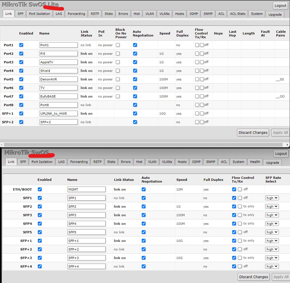

Hahaha…for a moment you had me there…CSS610 is running SOS-lite, not SWOS.

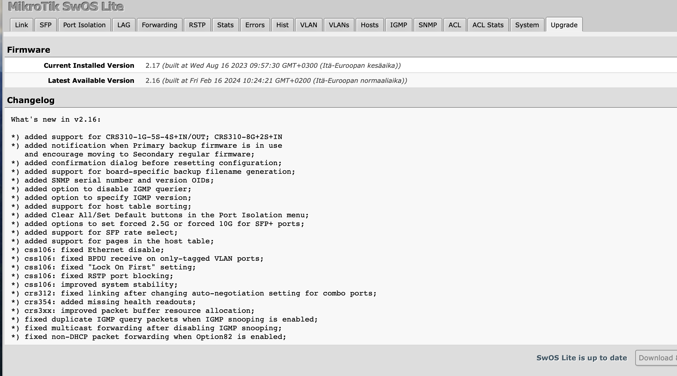

…but wait, what is that?..witchcraft, but non quite so (from my CSS610 on SWOS 2.17lite, showing the latest v2.16 of SWOS in the changelog :wink:
*) fixed non-DHCP packet forwarding when Option82 is enabled;

yeah i should have pointed that out. I find them both very clean:
