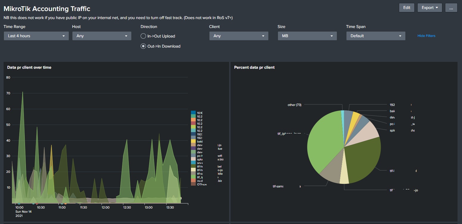

Here is some graf taken from Accoutning. Easy to setup and easy to graph with Splunk and handles many devices.
Accouning?
