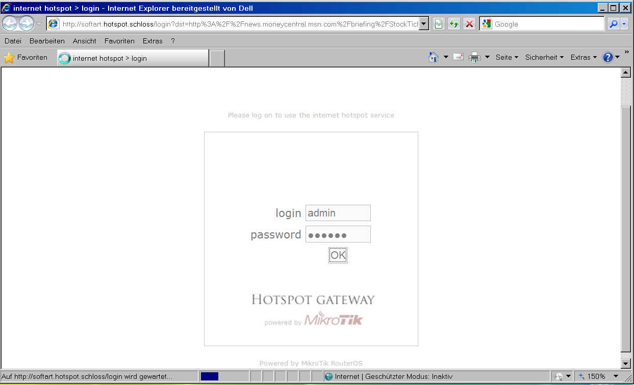

I have a working Hotspot, ROS 3.23, with customized login-page. And the same configuration on a test-PC, fortunately. After upgrade from 3.23 to 3.28 on my test-PC (fortunately, sigh) the login did not work any more. Suspecting some change in the Mikrotik-login-page, I did a fresh install of 3.28, with original Mikrotik-Login. And the same effect:
The login-page shows up on the client, but, after entering usr/pwd and clicking OK, the browser hangs in “Waiting for …” However, after clicking “Refresh” of the browser, the show goes on.

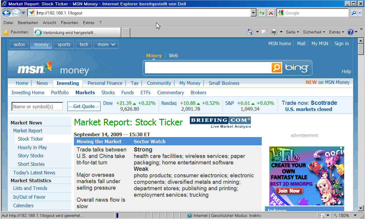

Similar effect on logout: Trying to logout accessing 192.168.1.1/logout, browser hangs in “Waiting for …”. However, after clicking “Refresh” button of browser, logout completes.
