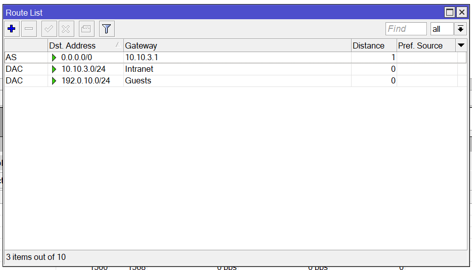

Here is where I am struggling. I’ve read through the VLAN tutorial (thanks for the reference) but the fritzbox doesn’t handle them at all. So instead, I went the route with setting up a seperate DHCP server and pool on the AX devices for the guest interfaces. When I connect to them now, my client device gets a proper address assignment from the pool and the gateway as well as DNS point to the AX device as well (pool I’ve assigned to the bridge).
Now my problem is how to get my devices to go over the trunk port to reach the internet. In my mind, I am thinking we are missing a static route. Looking at the table, the DHCP setup created a route for all IPs in the pool with the bridge as gateway. What am I missing here?
https://forum.mikrotik.com/viewtopic.php?t=182276
Now I am one step further into this whole dilemma. I’ve added a NAT rule to the AX devices (srcnat from https://help.mikrotik.com/docs/display/ROS/NAT to translate the source network address) which allows me to access my management LAN (I call this Intranet). I am unable to access the internet though, thought the issue is my DNS configuration in the DHCP server but even using the actual IP I am unable to access the internet. Feels like I am getting stuck at the fritzbox now, not sure why.
Any thoughts?

Thanks for the link. This solved my problem. I needed to correct the DNS assignment I had made on the subnet to match my intranet and voila. Got internet on the guest devices and will now add a firewall rule to prevent them from accessing my intranet.
Thanks for all your help!
