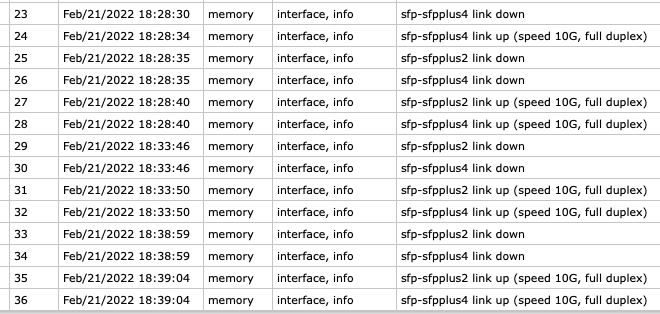

Unfortunately, all of the SFP+ ports are still flapping in 7.1.x for me, even with 7.1.3, on a CRS328-24P-4S+. Forcing the interfaces to 1G fixes the problem, but then I lose 10G. It happens at regular 5 minute intervals, which is extremely suspicious.
There hasn’t been an update to SUP-68278 since December 23rd about this.
