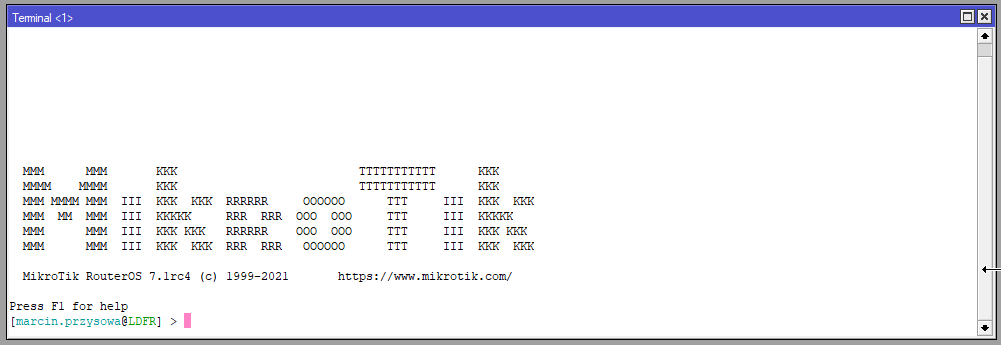

ReSize of terminal destroy MikroTik logo/code/output
