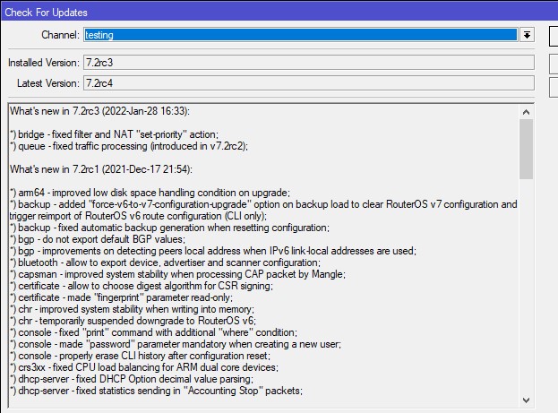

No release info on update
On my CCR1009 the wrong version description is displayed in the window:
*) bgp - fixed VPNv4 route sending to remote peer;
Only ONE item for BGP fixes? At this rate we need to go to 7.2rc19 before it is ready…
