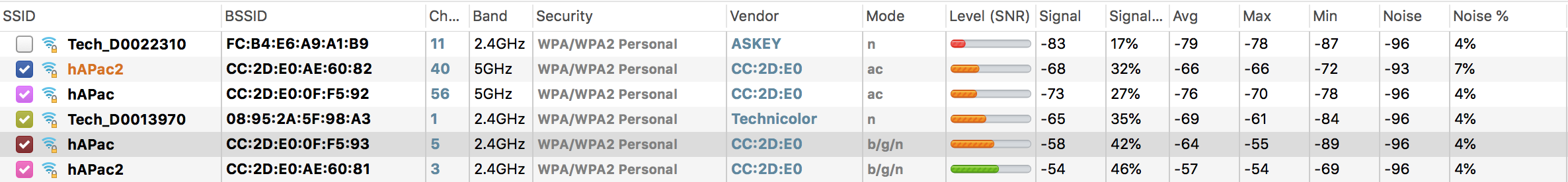

I’m doing WiFi coverage tests between 2 Models:
RBD52G-5HacD2HnD-TC (I will call it hAPac2)
RB962UiGS-5HacT2HnT (I will call it hAPac)
The suggested price of both models results in a price difference of $ 60.00
My question:
Where is such a big difference in suggested price, if in the WiFi coverage graph shows that the hAPac2 has better WiFi performance?
Do the real tests.

Note that hAPac has tripple chain 5ghz, while new ac2 has dual chain only.
So in theory if u connect to higher speed device with tripple chain like some apple copmuters, old one should be faster, but they removed extra chain on new one due costs, and very few people use tripple chain clients.
To answer your question on initial price positioning it is simple: hAP ac = 3x3 router while hAP ac2 = 2x2 router.
Also, whatever tests you have done do not appear to be particularly thorough. The hAP ac2 is suffering from serious stability and performance issues. The performance side is being very gradually fixed, but the instability remains for now.

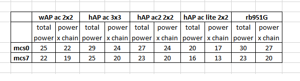

a comparison on mikrotik wifi tx power
2ghz radios
in theory hAP ac and hAP ac2 have similar and the best coverage because the same tx power per chain, wAP ac has less tx power per chain and hAP ac lite the lesser
a side note is the old rb951G with the highest tx power on lower data-rates but the same tx power as hAP ac and hAP ac2 on highest data-rates remember rb951G does not have 5ghz radio

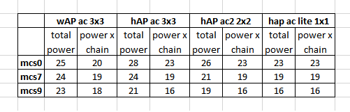

5ghz radios
in theory all products have similar coverage because off almost the same tx power per chain
except the wAP ac who has less tx power on mcs0 but more power on mcs9, in theory that means less coverage on lower data-rates but best coverage on highest data-rates
another factor to take in consideration is channel width, the bigger the channel the less coverage you get
https://wiki.mikrotik.com/wiki/Manual:Interface/Wireless#Transmit_Power_representation_on_802.11n_and_802.11ac
all this info must be take in count when selecting a device according to your requirements between coverage and performance on 2ghz and 5ghz
on wifi high tx power on access-point have limited benefits because client devices in most cases have total tx-power between 10dbm and 17dbm
