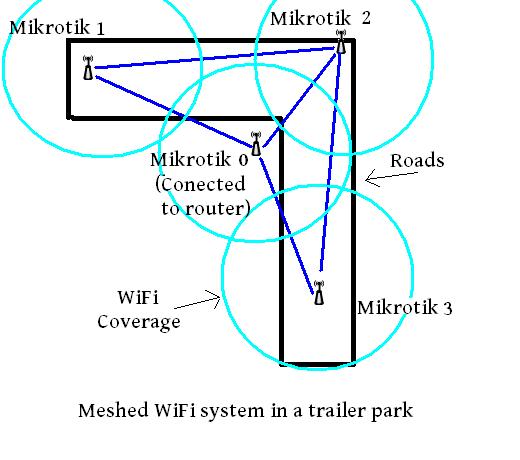

I am setting up a WiFi network in an RV park. In 4 locations I have an RB433 with R53hn cards, and 12db omnis. All are close enough to see each other.
My original thought was to mesh them, and let the cisco router that the customer already owns handle DHPC and all that jazz. I have attached a diagram to show the basic idea of what I am trying to do. (Sorry it’s so cheesy, I just made it in mspaint, it’s 10:00pm and I am still on site at this job lol.) Seemed easy enough, but now it’s kicking my butt.

What I need to do is to get these radios to link to each other, to share WAN access from the from the primary AP (labeled “Mikrotik 0” in my illustration), and also allow customers to get online via WiFi, using a single wireless card and antenna per AP.
