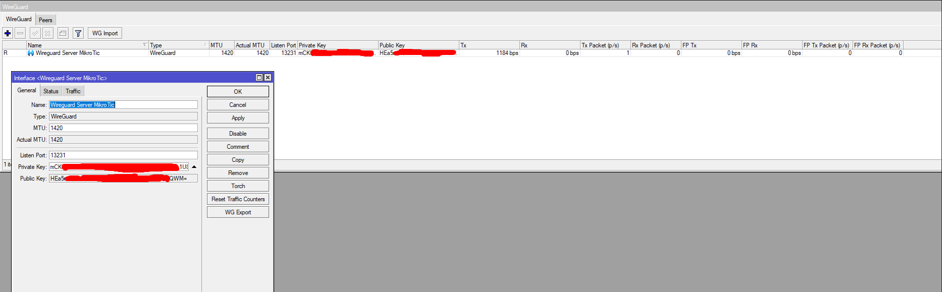

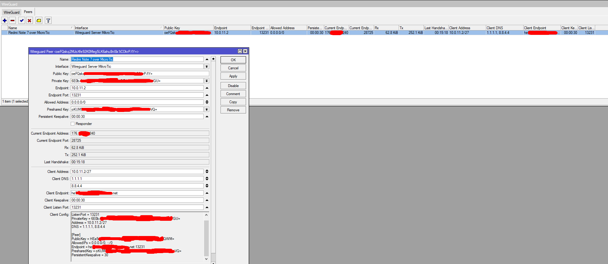

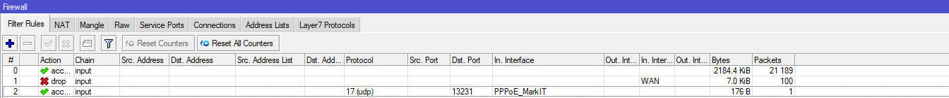

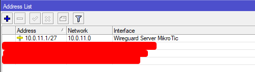

I have a problem creating a client to connect to the server
I get a white IP address from the provider, I have the following settings in the router
The problem is the following, after I reboot Mikrotik, I need to wait from 2 to 4 minutes and periodically switch the slider on my phone so that the connection to the server from my mobile network occurs, if I just leave it on, it will never connect, only when I move the slider, I want to have access to the Internet from this Android phone, I saved the public and private key from the phone, inserted it into the configuration on the router and then connected using the QR code. Please tell me what else I could have done wrong, maybe the NAT rules still need to be added?
