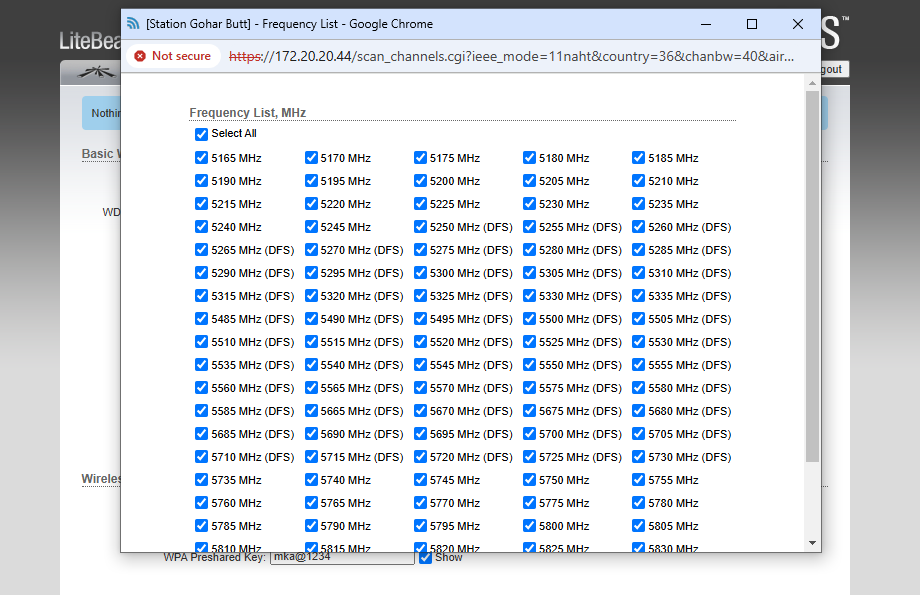

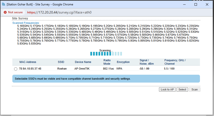

I can’t see Mikrotik NetBox 5ax APs “SSID” when Start Scan LiteBeam M5 and not seen in SXTsq Lite 5
why is it…???
only Omnitik found in a site survey

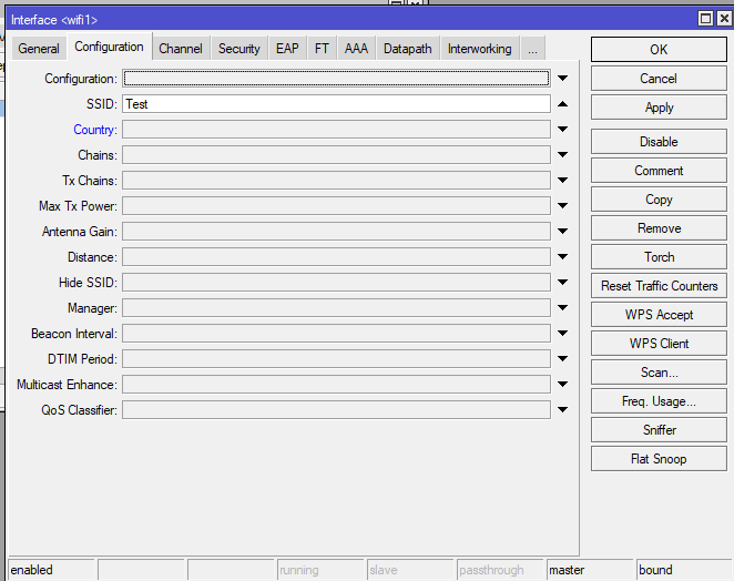

configuration.antenna-gain=20
Can you lower it down, 20 is high

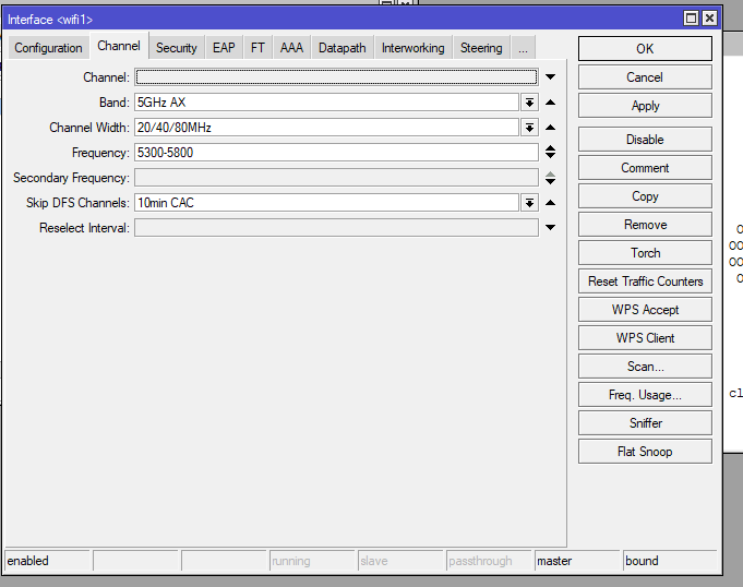

in your radio configuration, change what you have defined for frequency
you specified 5200-5800
replace with
5180 [new line]
5240
5765
Also set DFS to SKIP ALL.
Try the 5180, or 5240 frequencies.
