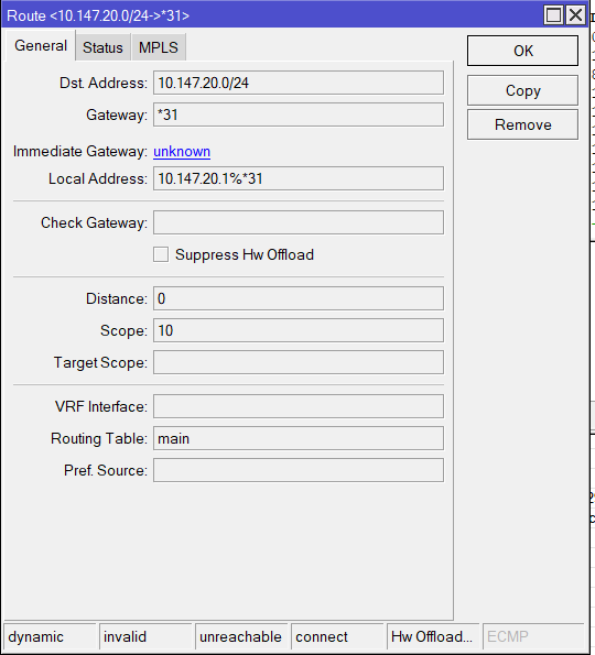

The Chateau connected to my Zerotier network with no issues via LTE. However the RB3011 is displaying the following:
The Zerotier Network is not being advertised yet so it’s not a routing issue. You can see from the screen shot that it says Immediate Gateway Unknown.

This * stuff usually means that there is a reference to an unkown interface.
Have you tried renaming the zerotier interface?
Does it look different in the cli?
This is a Winbox bug. Check console, it must be OK there. Since Zerotier was just added, Winbox doesn’t support it in some places yet

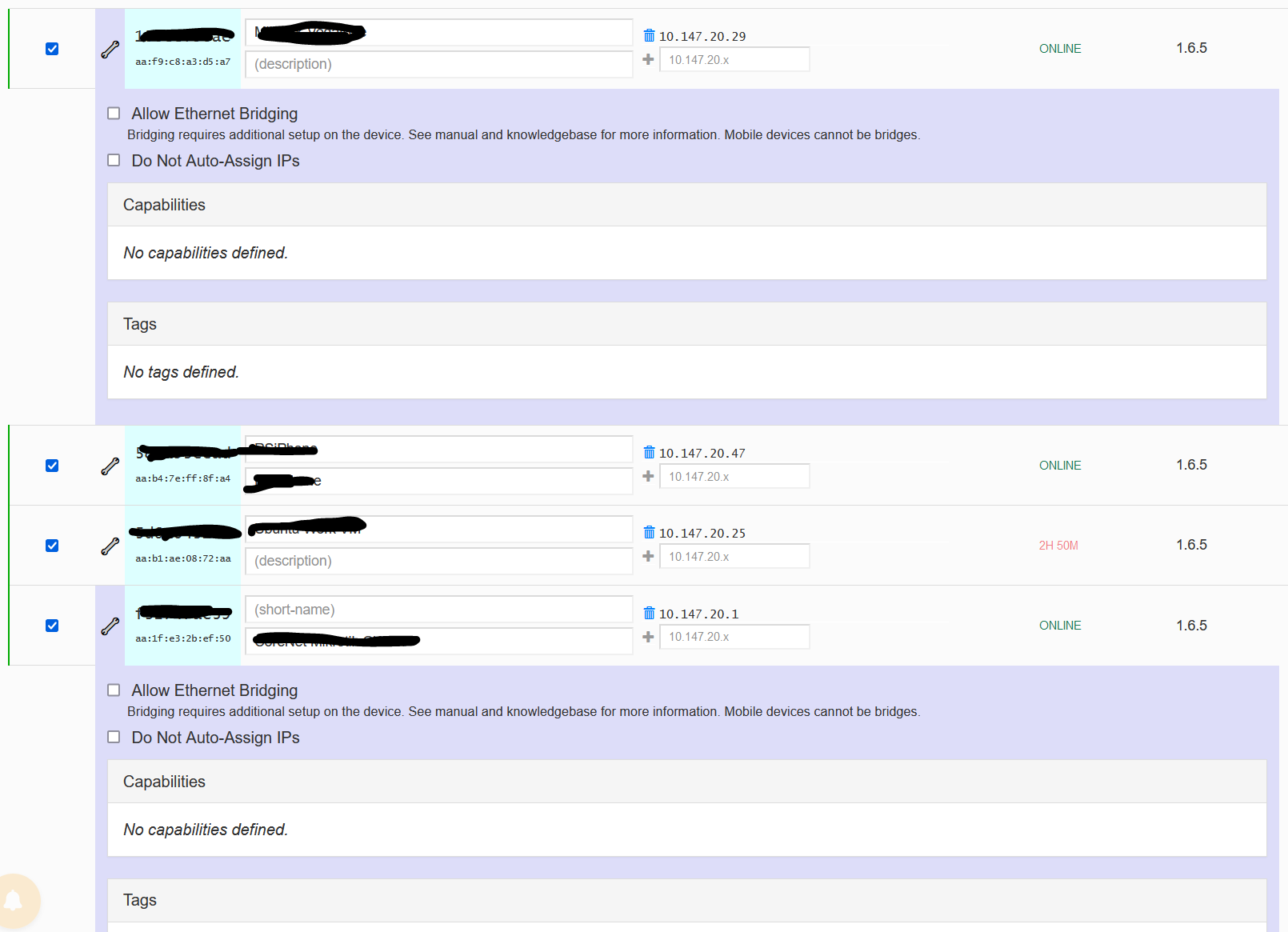

The chateau as you can see below is different. On the Zerotier Control Panel they all have the same configuration.
Maybe it’s just the RB3011 hasn’t correctly picked up its configuration from Zerotier though.
Edit - Although I did have the same issue joining a completely new Zerotier Network that i set up for testing.

The first expanded entry is the Chateau (10.147.20.29), the lower one is the RB3011 (10.147.20.1)

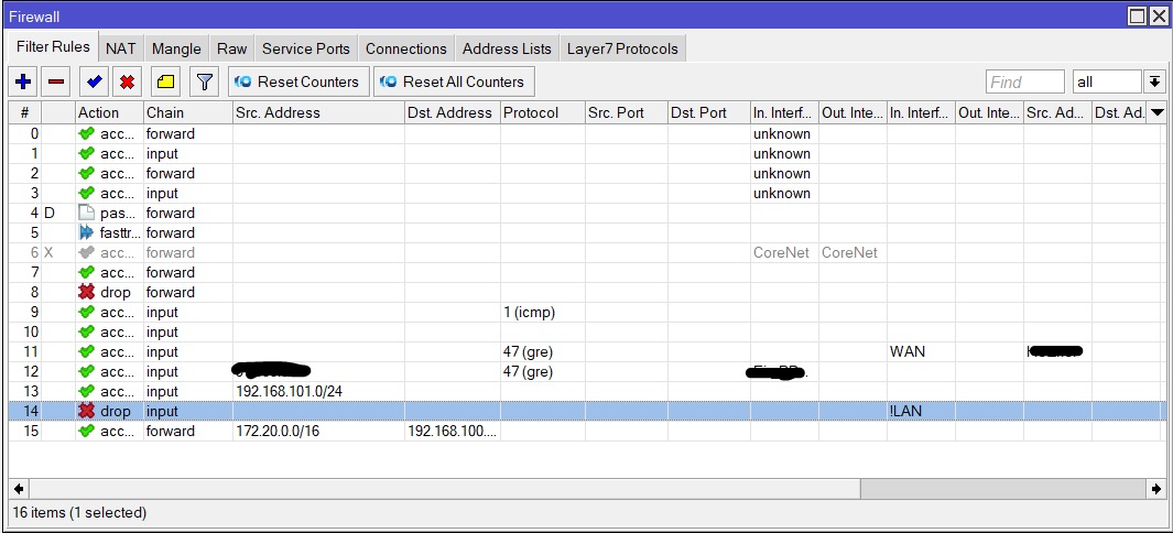

If I disable Rule14 it works! Yet the Chateau also has the same rule.
disabling that rule is very dangerous. better add accept rule from zerotier1 interface
