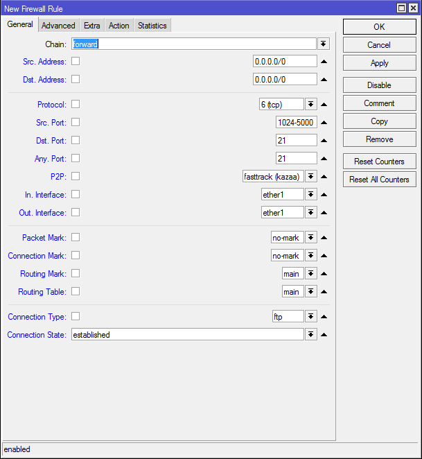

Bug on this new interface.
Bridge filters with in/out interface simply "disappear" from winbox but still appears on console.

In version 6.11 I can't see a greater amount of ports entered in the firewall rule. I have to scroll through them
You do not have the required permissions to view the files attached to this post.

Can not change the ip adress of the local network in quick settings??
The ip adress has changed form the original one to 192.168.2.250??
Edit2: fixed the above, my fault, wrong config.
And what is WISP AP??
Edit:
Some wireless settings where changed without touching them, like Channel Width...
In Interfaces, settings for masterport where changed...

Can you please revert width of text fields in WinBox????

Mon Mar 24, 2014 3:24 pm
+1
+1
Normis , this is a modification or a bug?

Mon Mar 24, 2014 6:42 pm
Normis,
Is the winbox text box a bug or on purpose? It is HORRIBLE!
Please revert this back to the previous behavior. I don't see any logic in this change (If it is not a bug)
Seriously, what's happening with the quality control at MT? This is crazy the bugs people are finding. Most are accurate and are able to be reproduced, so they are legitimate. This should not be happening.

Anyone open winbox / ip / firewall on 6.11 can see misaligned active fields:
On 6.11 or 6.12 open Winbox 2.2.18 (download from mikrotik.com or from http://$routerboardip/ is the same)
Go to IP, Firewall, NAT,
Click on "+",
On General tab, click on any field,
The field are now aligned on the right and the space available is small.
Still present on x86,mipsle,ppc [not try other] 6.12 2014/03/24 08:25:43

  • Winbox field width is a bug, and is confirmed, don't worry, it will not remain like this.

Good morning, after upgrade I see this - the select box is not full width in WinBox. It's normal or bug? I didn't see this in earlier versions.
Same here

I have found another problem with 6.11. In winbox' s bridge filter, the added interfaces disappeare after a few seconds. But there are available after editing the rules.

Does anyone able to use the routing mark + the "Content" field working correctly ?
As soon as I add anything inside the field "Content", the connection will timeout . For example, if I type in "facebook" in the Content field, it supposed to mark the route if I go to http://www.facebook.com . And then eventually route to a VPN connection. However, the connection would time out as soon as I go to http://www.facebook.com.
However, if I take out the "Content" field and make it to mark the route unconditionally, when I go to http://www.facebook.com, it will route to the VPN correctly.
Therefore, it seems adding a condition will break the routing mark.
Going to HTTP facebook will automatically redirect you to HTTPS facebook.
Since its HTTPS, the router cant read the packet content (its encrypted), and therefore will NOT find "facebook" in the content, and not route the connection over the VPN.
The HTTPS connection begins with server certificate transfer to the client. This phase is not encrypted so the router can see what is in the certificate body and there are server names:

So this content firewall rule "facebook" can catch connection to the Facebook.
But if is firewall and routing constructed in the way that new connection to the Facebook is opened directly to the Internet and after few packed is rerouted to the VPN then connection may fail if access to the Internet from VPN uplink use different source IP address.

Winbox field alignment on Firewall section FIXED.
