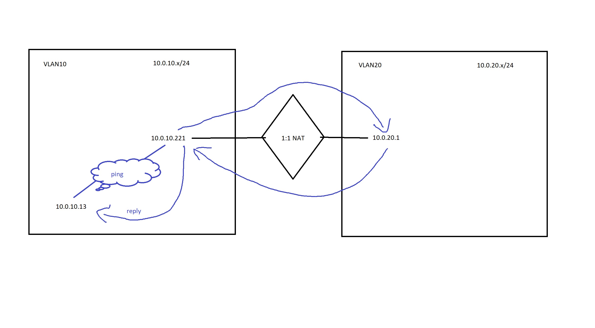

Hi anav, thank you for your reply!
Sure, attached a simple diagram of what i need to obtain from this NAT configuration.
I have created this thing on Fortinet in this way:
  • I’ve created the IP object 10.0.10.221 with name Device1
  • I’ve created the IP object 10.0.20.1 with name NatDevice1
  • I’ve create a firewall policy that allow traffic from VLAN10 with source Device1 to VLAN20 with destination NatDevice1
If I’m on 10.0.10.13 IP, for example, and I ping 10.0.10.221, i receive reply with no problems.
I’m not understanding how I can replicate this configuration on Mikrotik logic.
Thank you so much for your help.
