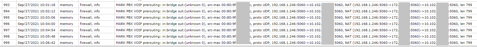

but in this way, the packets are marked correctly (as shown in the attached logfile) but the routes based on routing mark don’t work as expected and the packets are not forwarded correctly.
