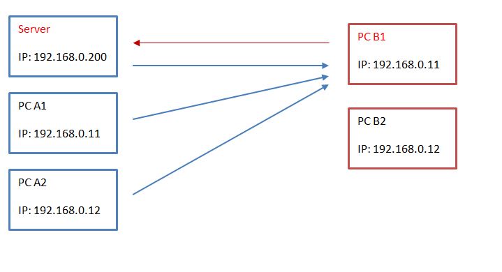

Hello
I have a question
I have 2 networks.
The PC B1 needs access to the server
The server and the computer by A need to access the PC B1
How can i configure this?
I ask for help
Thank you very much
Hello
I have a question
I have 2 networks.
I ask for help
Thank you very much

Thanks for the reply
@Sob:
Yes we have 2 networks with one same ip (192.168.0.11).
Network A is the Network from my company. We can’t change this.
Network B is a NC-Machine. We can’t change this IP!
Only, it is important that the server from network A (192.168.0.200) can connect with the host from network B (B1 192.168.0.11) Ping and tcp.
And the host (B1 192.168.0.11) can connect the Server. Ping and tcp.
All other computers have no connection.
The problem is that I already have the IP in the network A and can not change this.
They are all static IP addresses.

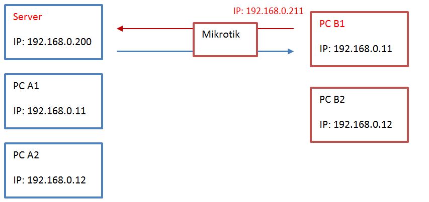

The router must translate the IP 192.168.0.11 from network B into a different IP, for example 192.168.0.211.
Then the Server can connect with the Client from network B (B1 192.168.0.11) over the IP 192.168.0.211.
Otherwise, the router has no tasks
Is this possible?

But if full communication between any host in network A and any host in network B is not required, it’s possible to do something like this:
set [ find default-name=<network A interface> ] arp=proxy-arp
add address=192.168.0.211/24 interface=<network A interface> network=192.168.0.0
add address=192.168.0.210/32 interface=<network B interface> network=192.168.0.11
add action=dst-nat chain=dstnat dst-address=192.168.0.211 to-addresses=192.168.0.11
add action=masquerade chain=srcnat out-interface=<network B interface>
add action=src-nat chain=srcnat out-interface=<network A interface> \
src-address=192.168.0.11 to-addresses=192.168.0.211
Fake address .211 will be visible in network A. Any host in network A will be able to connect to it and it will be forwarded to .11 in network B, where it will look like it comes from .210. It’s one direction. For the other one, .11 from network B will be able to connect to any address in network A, which is not in use in network B. So it will be able to connect to .200, but not to the other .11, .12 and .210. From the description so far it should be enough.

Oops, sorry, error in testing… but it can be fixed:
add distance=1 dst-address=192.168.0.0/24 gateway=<network A interface> routing-mark=lanA
/ip firewall mangle
add action=mark-routing chain=prerouting dst-address=192.168.0.0/24 \
in-interface=<network B interface> new-routing-mark=lanA passthrough=no
Now A .11 can connect to B .11 (using “virtual” .211).
It’s still not possible the other way around, but going by the arrows in original picture, it’s not necessary. Although why not, lets make .210 do the same for B network what .211 does for A network:
/ip firewall mangle
add action=dst-nat chain=dstnat dst-address=192.168.0.210 to-addresses=192.168.0.11
Now B .11 can connect to .210 and get to A .11.
