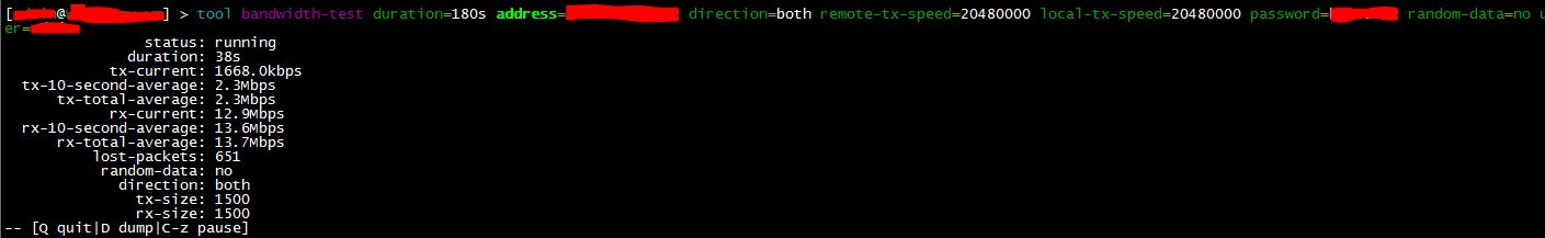

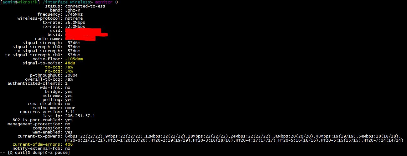

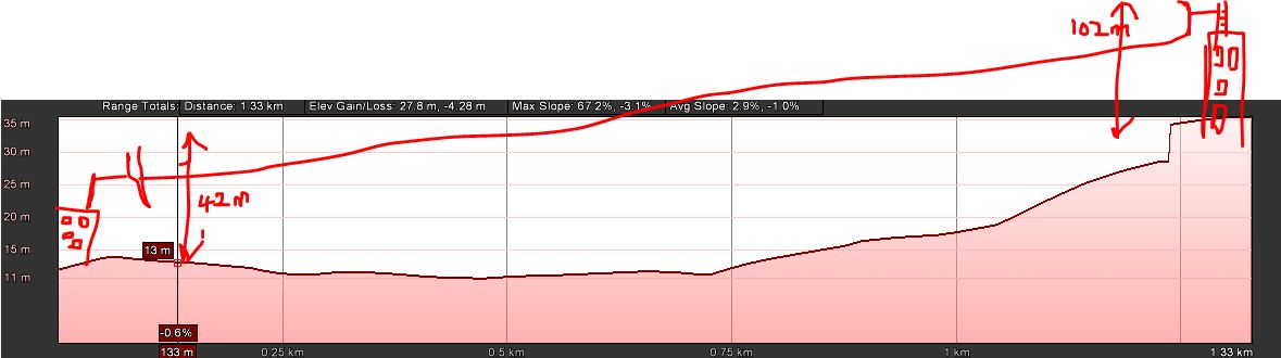

I am experimenting with the NV2 protocol and both RB have latest firmware and ROS 5.11. Please find below screenshots of detailed setting, bandwidth test, spectral-history and topographic sketch in the pdf file attached to the post.
As can be seen the bandwidth sucks - 13mbps down and 2.3mbps up from station bridge side (given a steady signal strength range of -55dBm to -57dBm approx although noise floor seem a bit high -105dBm).

I changed from nv2 to nstream. I have seen positive changes in ping response for packet size 1500 (latency from average of 65ms to 8ms)
but am getting lot of hits in “current-ofdm-errors”. Is it possible to lock the link to certain speed. e.g. 45mbps.
