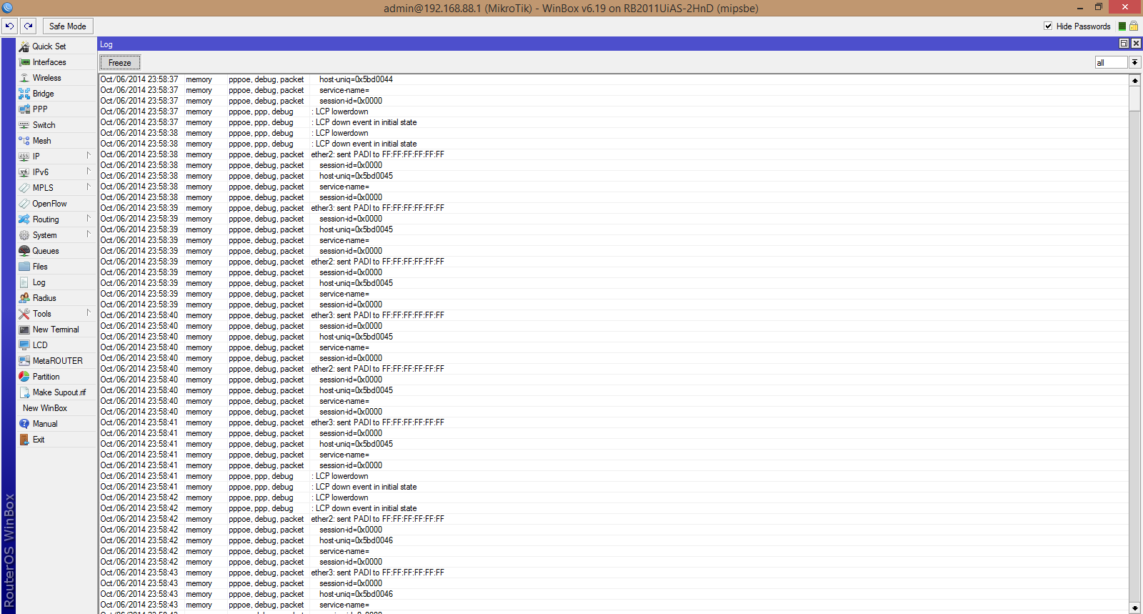

The PPPOE log is as follows:
Please advise if you need more information or have any idea what is causing the issue.

Make sure that ether2 and ether3 do not have master ports configured / are not configured as some other port’s master.
Also - I and other users have had issues between the gigabit ports of the 2011 and some broadband modems.
Try configuring the pppoe on ports 8,9,10
