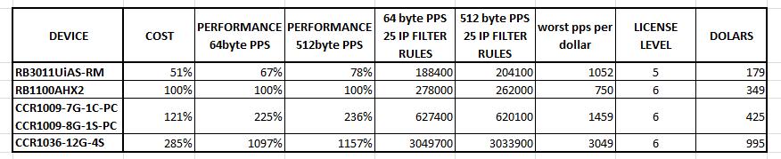

i compiled data for this comparison to make things a little easier
Thanks, great comparison! I’ll see if the budget will be enough to go for a more enterprise grade solution with ccr1009.
