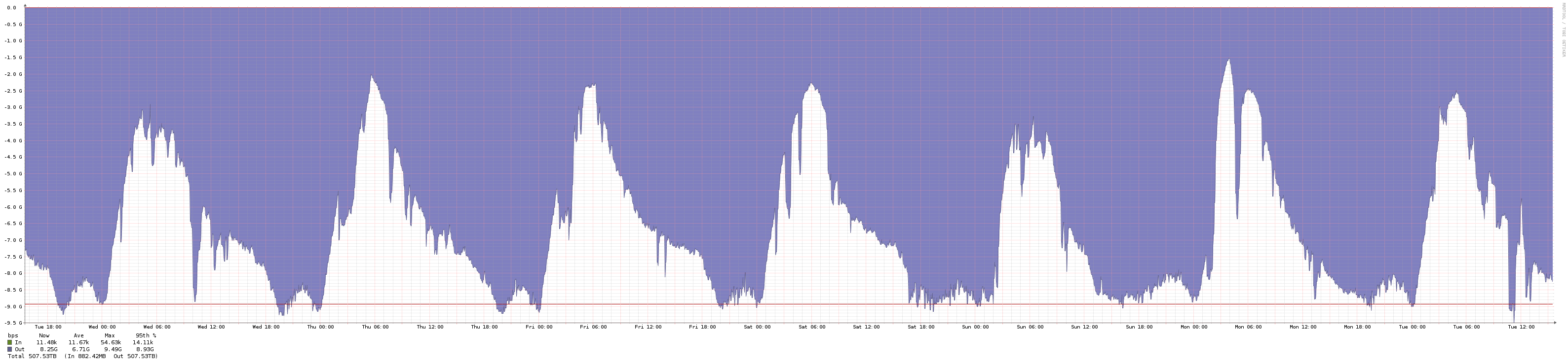

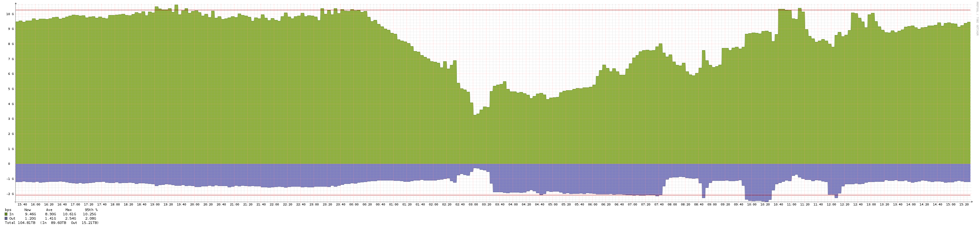

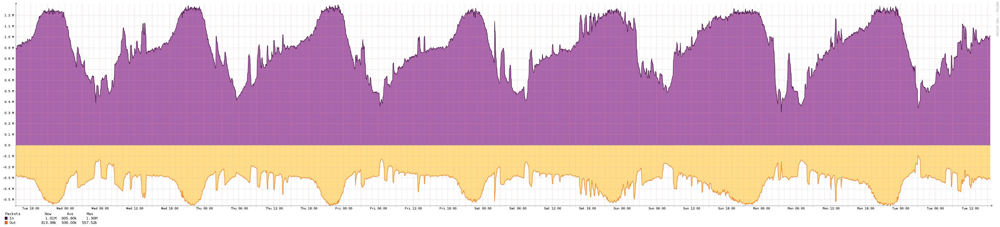

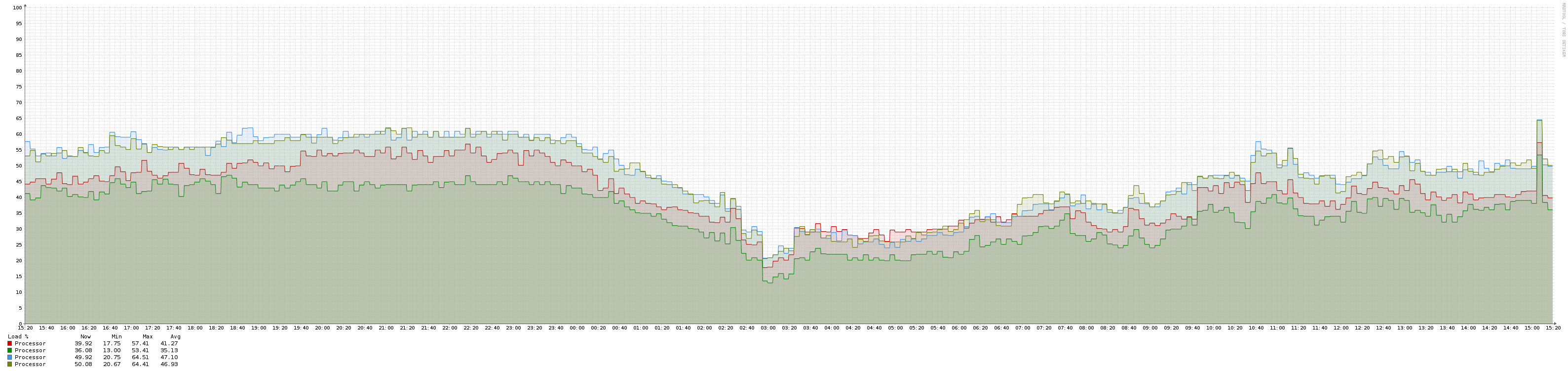

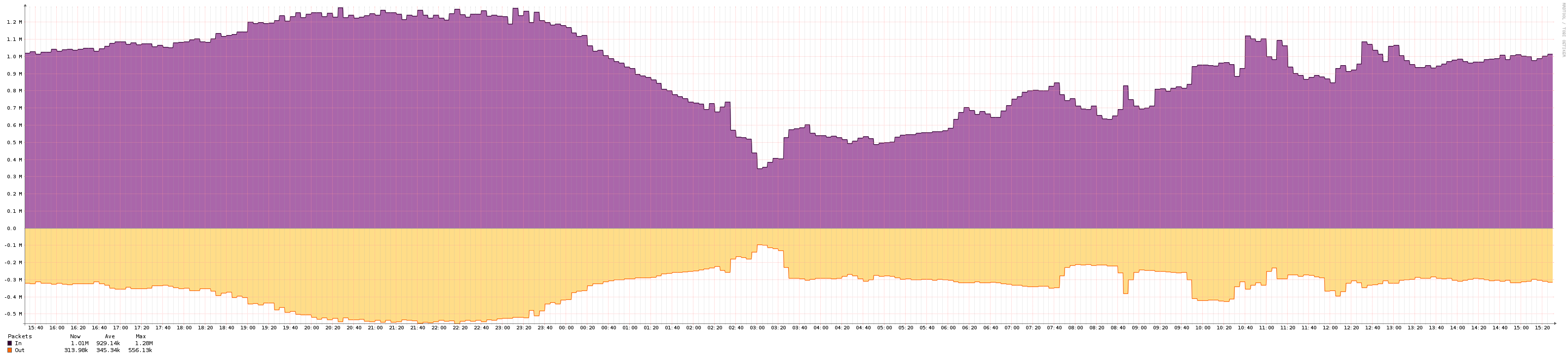

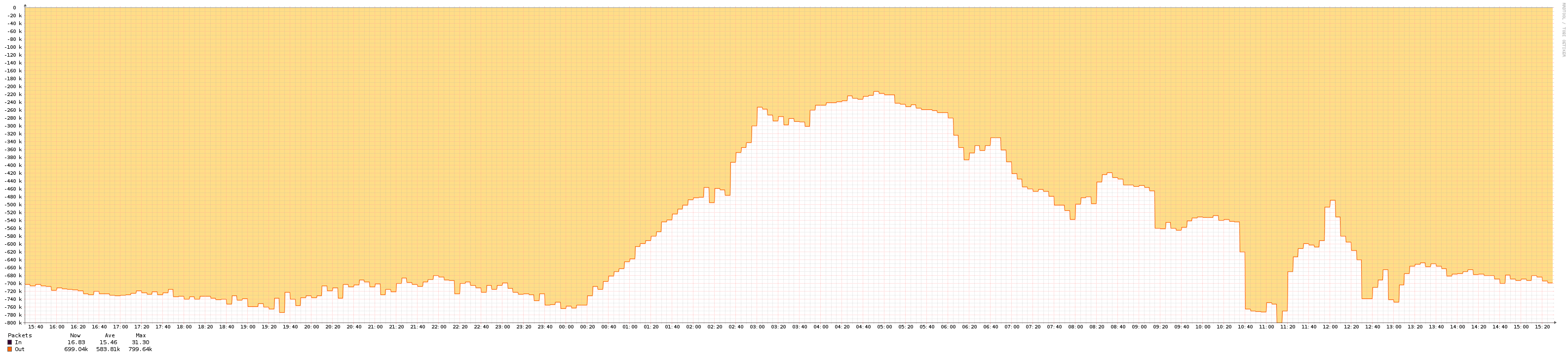

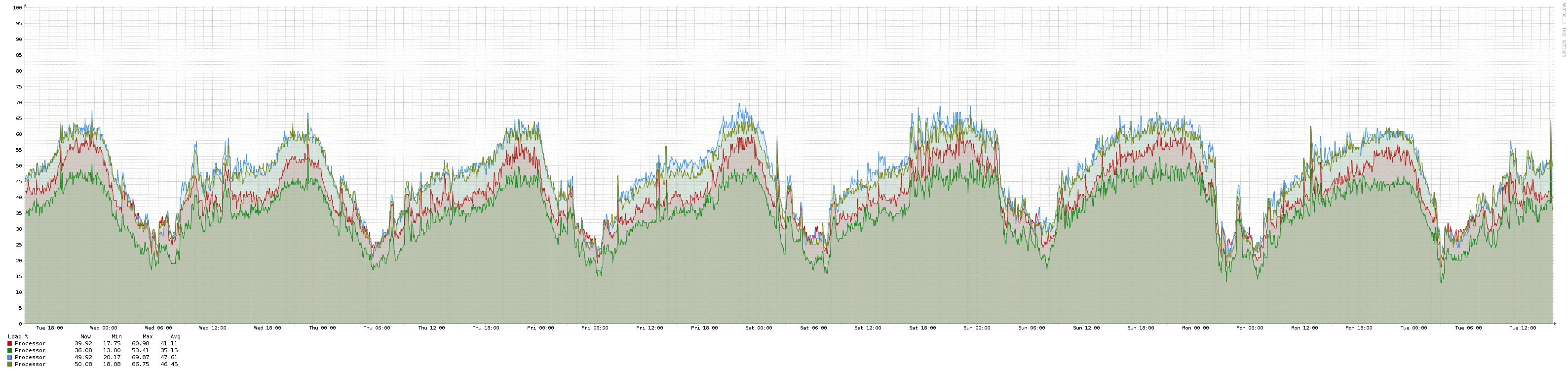

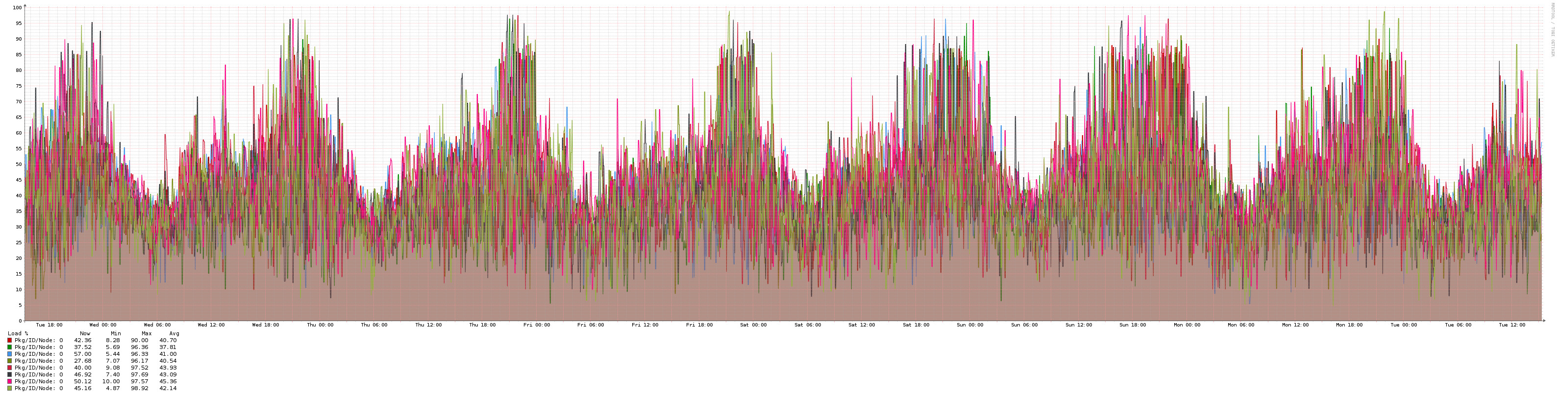

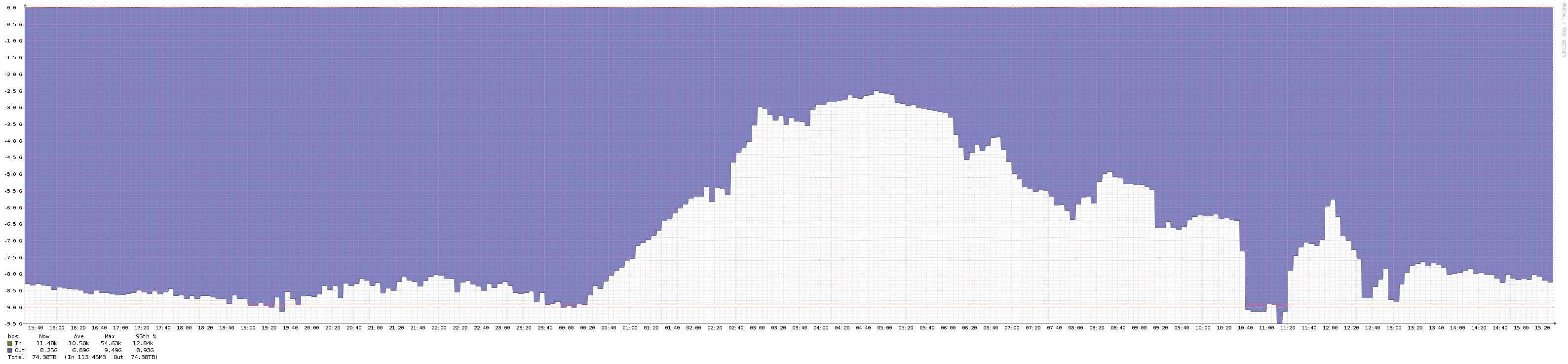

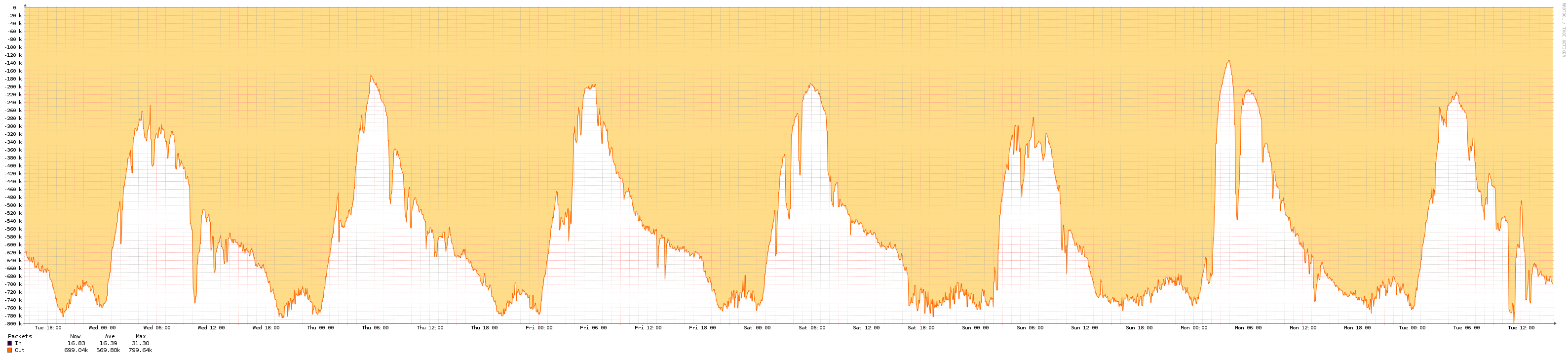

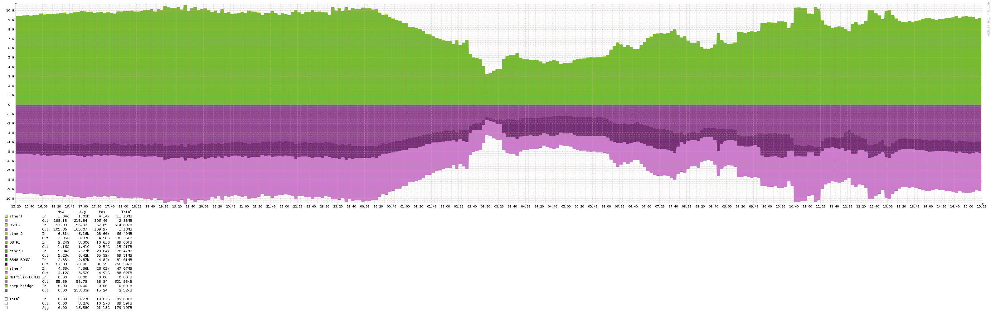

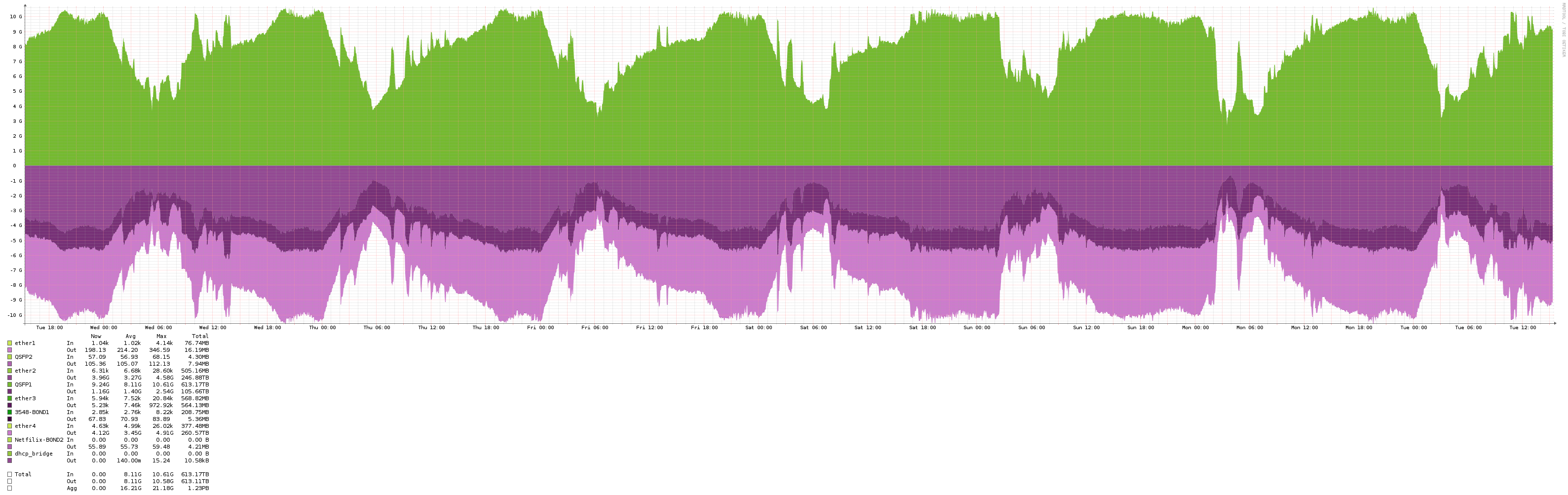

Here are some updated CPU load and throughput charts, with all of our latest changes.
I did remove as much virtual hardware as I could.
I’ll have them check the host BIOS for things to shut off.
Try to play with interface queue.
What the difference in test CHR and production on load /tool profiler?
The only thing the test CHR is for being a ping destination. It has one interface, one IP address, etc
The queues are set to multi-queue-ethernet-default for the virtual NICs. I forgot to change the settings on the ones I did PCI passthrough on. Does the RouterOS driver for Intel 10G NICs support multiple queues?
