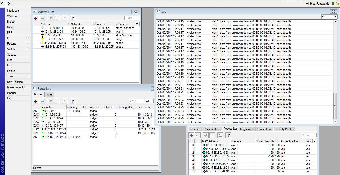

Your signal strength range in the access list is set to “0”. Set it like the rest, default.

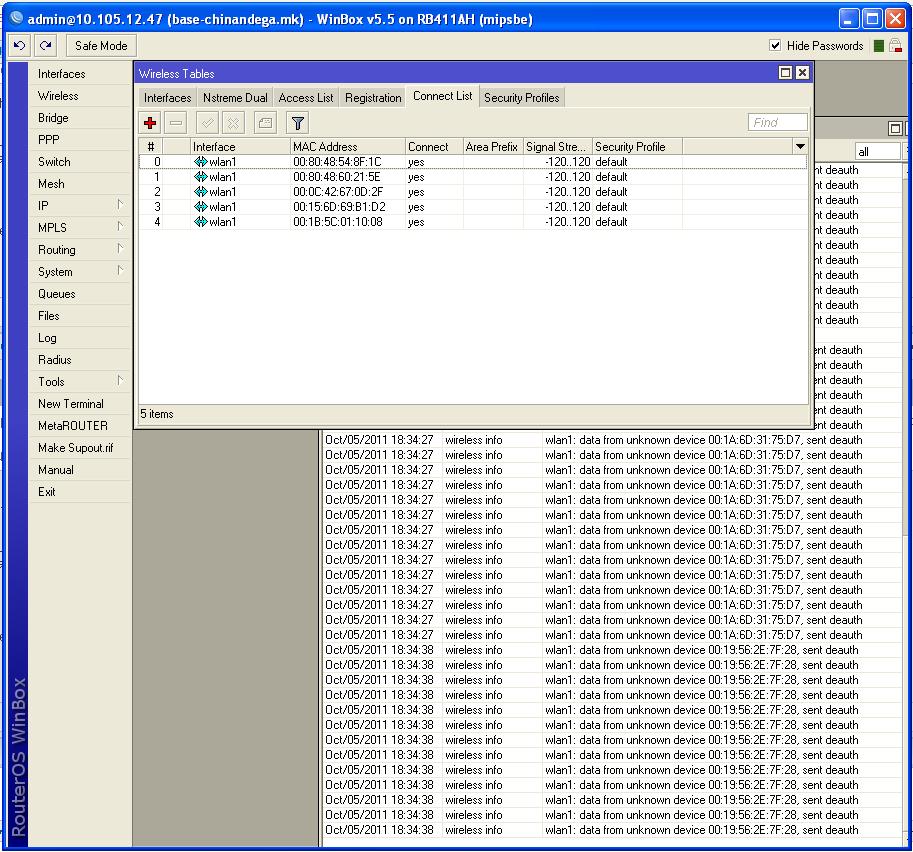

Explain better what is happening and show us also prints of the log, register and access-list and all other wireless related info.
los mensajes son los mismos, una de las direcciones macadress proviene de un cliente conectado a mi wireless, pero no corresponde al radio que se conecta, me parece que viene de un router que el cliente tiene en su red.
messages are the same, one of the addresses from a mac address connected to my wireless client, but not for the radio to connect, I think that comes from a router that the client has in its network.

00:19:56 & 00:1A:6D belongs to Cisco Systems …
If the CPEs are UBNTs (mainly Bullets, Nano2/5, Nano 2/5 Loco) configured as bridge you can expect some mac “leaks” from customer LAN. May be other CPEs manufacturers have the same “hole” when configured as bridges.
