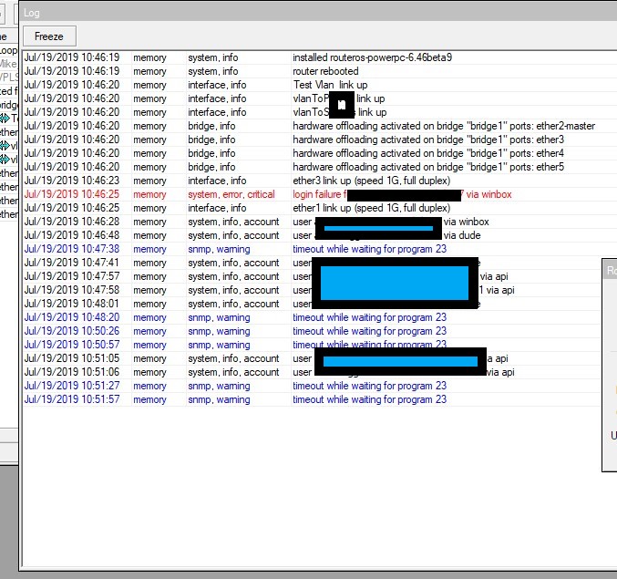

After running a firmware update, in fact any firmware past 6.42.x causes multiple devices to lock up, and causes the DHCP server to not start, the CPU is at 100% and barely passes any traffic. The logs show unable to start a program. Note: only 4 out of hundreds so far, but it’s still devices that should be working well.
The issue at this point is that Sonar cannot connect to these devices because they’re a lower firmware version not using the new authentication methods. Which i’m assuming is the root of this problem. I wonder if mikrotik can help us fix these or get them RMAd.

Thanks for the answer, we don’t have serial cables connected, and the serial doesn’t show up in our profiler, so it’s not the issue
