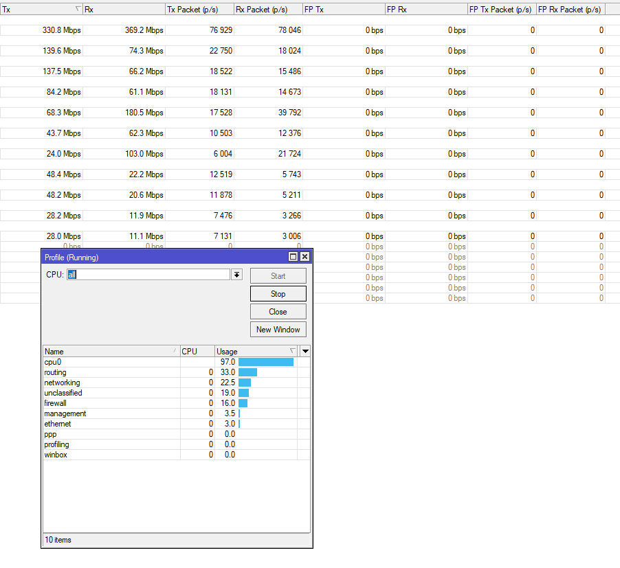

Now some traffic is running over the CHR and the router is already unusable. 100% CPU usage for the most part, ping dropouts, packet loss etc.
Here is an overview of the disaster:

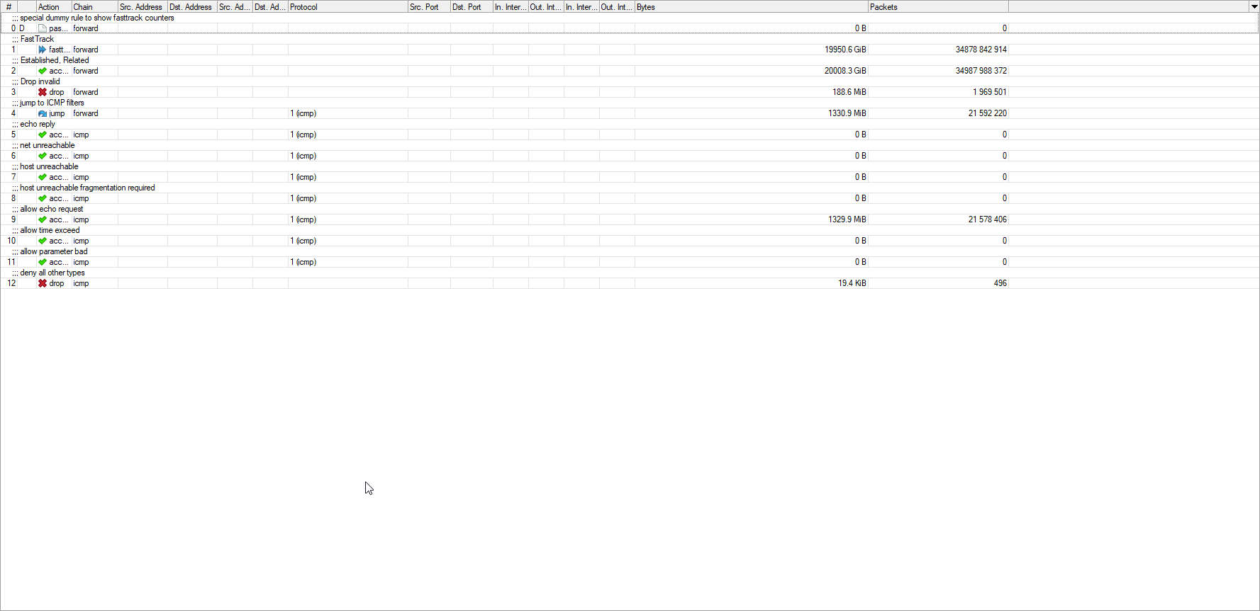

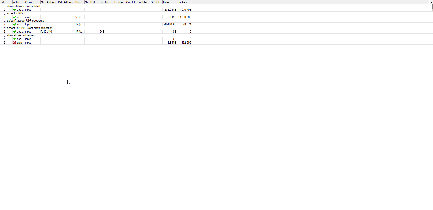

Now the question, why does mikrotik only show me “CPU0”, the system actually has 2 CPUs and 24 cores. Why does the system reach its limit so quickly? That can’t be right. I only have the following firewall rules:
Rules v4
Rules v6
What am I doing wrong? Am I just stupid?

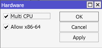

IIRC on the System → Resources dialog, there’s a “Hardware” button. Can you try to click it and make sure the “Multi CPU” checkbox is ticked?
Hey, thanks for your message.
Yes both checkboxes are filled.
I installed the x86 version bare metal with an L6/PU license.
Don’t know if that helps or not.
