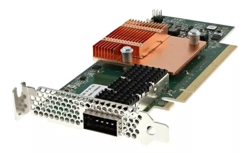

i am planning on testing this model Qsfp28 Pci 3.0 X16 0n64d3 Omni Path on a Dell R730 but not sure if its worth spending $$ buying for testing without support.
If this is Intel 100HFA016LS or other similar Intel OmniPath - this card supports OmniPath only - no support for Ethernet at all. This card will not be supported in RouterOS.

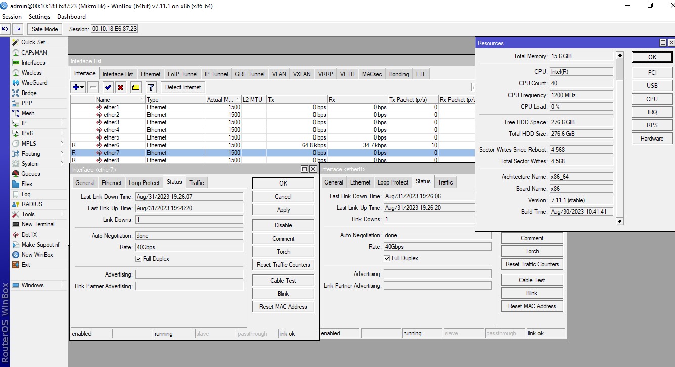

after that i made a firmware flash upgrade to the card, running on a windows 10 machine. after finally flashing the firmware sucessfully i have rebooted the pc windows with the card, and after reboot i checked that the card was on mode 3 which is auto to work vpi and eth, so i removed the card and inserted on mikrotik server, but still the card was not showing up the ethernet ports… so i shutdown the routerOS server, and rebooted the card inside the windows machine, and went to the firmware tools configuration mode and set the card to mode 2 Ethernet only. saved config and rebooted the machine .
After checking that the card was ok only with ethernet mode setup, i have removed the card and placed it back in routerOS server , switch the server back online and the 2 new ethernet ports 40G showed up, tested connection on both of them with a 40G dac cable i had, and both came online with autonegotiation showing 40Gbps..

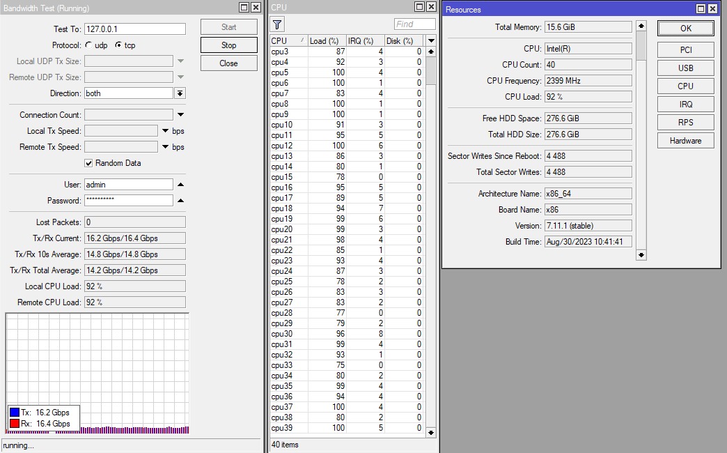

BTW i am running the RouterOS v7 on bare metal on a R630 with 2 E5-2697v2 for troughput testing purposes.. waiting on new toy R630 with 2 E5-2699v4 to arrive for real testing.
