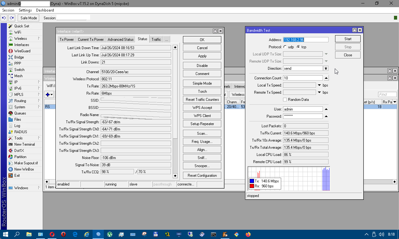

100+ mbit in 1way test, 3mbit in both way test
I recently changed a mixed ubnt-mikrotik link (that was working okayish) to a mikrotik ac link.
it’s going from a village to the city.
i did my best to re-allign the dishes, consider this is a NLOS link, slight visual obstruction. i think just the roof of the house in front is the only obstruction.
it’s a 6-7km link.
i tested a few frequencies and decided on a cleanest one, although antennas do not have much gain on the low end of the 5ghz band. in the mid band i was seeing -60 but i couldn’t fit 80mhz channel there, and there’s interference very near both top and bottom of the 40mhz channel and we know mikrotik don’t like co-channel interference. it was working but not as fast as here.
i tried both nv2 and plain 802.11ac and decided to use 802.11ac , it’s completely clean air and is more stable that way.
that said - why when i do test in both directions i see this shit speed?
speedtest is over 100mbit each direction, internet speedtest shows me about 95/90mbit…

i don’t have computer on the remote point, it’s just a ptp relay station. there’s an omnitik poe for powering ap devices and then a total of 3 ptp links.
from what i can see unidirectional works quite well so in real life it should also work well. i will probably see saturation in download, but i don’t think there’ll be much uplink.
ps didn’t know this thing about ack packets etc. i never bothered to test in both ways , this is the first time i think, so this bad results shocked me frankly. but i’d say this is working. if unidirectional goes 100-140mbit, then even with 10-15mbit uplink (if ever) the downlink should still go above 50. it’s plenty enough.
