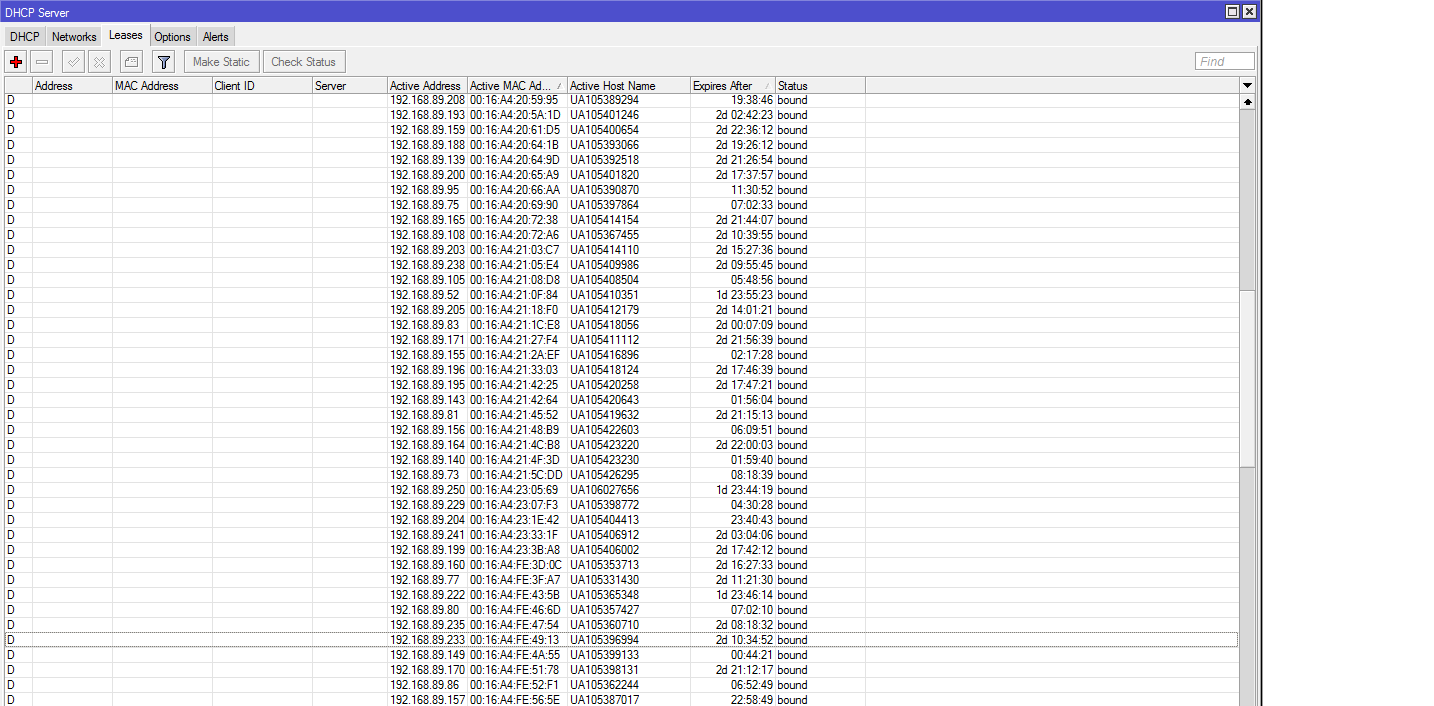

I set up an open wifi hotspot for a community organization not too long ago and today I noticed the dhcp pool was depleted. I looked through the leases and almost all of them were assigned to devices with mac addresses starting with 00:16:A4 and hostnames starting with UA105.
A mac address lookup points to ezurio ltd which was aquired by Laird http://www.lairdtech.com/NewsItem.aspx?id=1012
It almost seems like a bot with the sole intention of depleting the ip pool. There can’t be the sheer amount of separate devices that are showing up in the ip pool. It’s like the device is changing it’s mac and it’s hostname and then reconnecting.
Hopefully someone can shed some light on the matter. I attached a pic

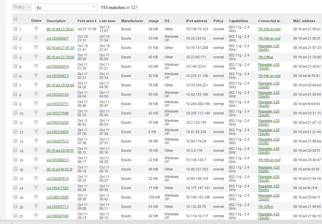

I found this post after I noticed Ezurio ltd mac addresses filling up our probe logs too. It sent about 500 different MACs over a few hours.
I’m not sure if it’s a (weak) deliberate attack, or a vendor being too cute with MAC tracking obfuscation.
MAC                        probe count              Vendor
00:16:a4:01:87:46	4	06/25/2014	ezurio ltd
00:16:a4:21:2b:48	4	06/25/2014	ezurio ltd
00:16:a4:21:34:ea	4	06/25/2014	ezurio ltd
00:16:a4:20:5e:12	3	06/25/2014	ezurio ltd
00:16:a4:fe:8d:d0	3	06/25/2014	ezurio ltd
00:16:a4:01:6e:0d	2	06/25/2014	ezurio ltd
00:16:a4:01:79:f3	2	06/25/2014	ezurio ltd
00:16:a4:01:7b:37	2	06/25/2014	ezurio ltd
00:16:a4:01:98:43	2	06/25/2014	ezurio ltd
00:16:a4:01:a5:50	2	06/25/2014	ezurio ltd
00:16:a4:20:03:f8	2	06/25/2014	ezurio ltd
00:16:a4:20:19:f4	2	06/25/2014	ezurio ltd
00:16:a4:21:05:2b	2	06/25/2014	ezurio ltd
00:16:a4:21:69:6c	2	06/25/2014	ezurio ltd
00:16:a4:21:76:fa	2	06/25/2014	ezurio ltd

I ran into this problem a few years ago. Back then I added a bridge filter rule with a MAC address mask to prevent my DHCP pool from filling up. Today I saw my bridge filter rule and forgot my reason behind it. A quick Google search brought me to this thread and I remembered. I figured I’d share my filter rule for others who are looking for a solution on Mikrotik hardware. Note: I chose to block all traffic from these devices because I couldn’t find a legitimate case where this OUI would be assigned to consumer hardware.
/interface bridge filter
add action=drop chain=input comment="Block Ezurio devices" in-bridge=Hotpsot src-mac-address=00:16:A4:00:00:00/FF:FF:FF:00:00:00
