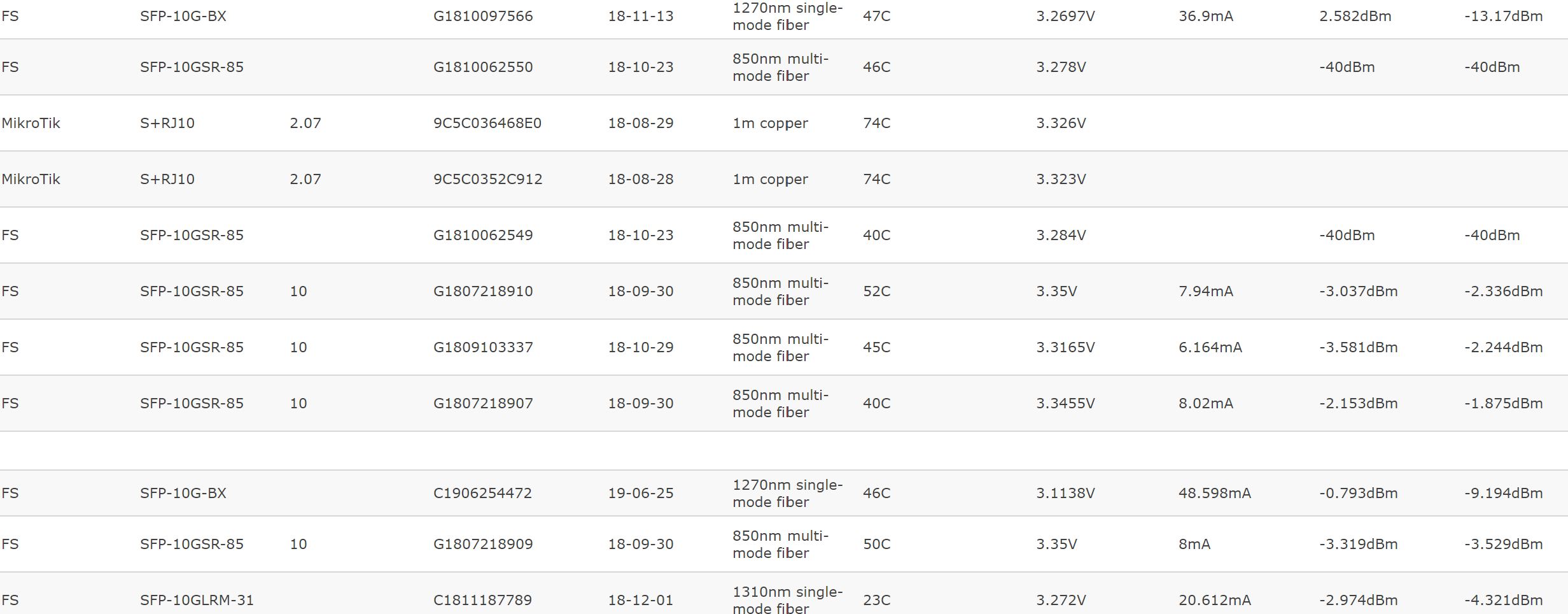

We using FS.COM SFP+ modules (single-mode, single-mode BiDi and multi-mode), without any problem at all, on many CRS317, 326, 328, RB4011, CCR1009,
